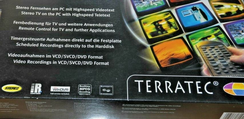

    Sorry, just one final question but I couldn't find any info online, does this card have hardware compression or I can capture straight rgb or huffyuv from it?
    The one I found on ebay has labelled "Real time MPEG2 encoding", is it just an option or the hardware compression?
    [Attachment 59999 - Click to enlarge]

    My guess, and it is only a guess, is that this card is on-chip/hardware encoding to mpeg. Quite a few Hauppauge cards do that as well.
    'Real time' is somewhat confusing since my Hauppauge USB-Live2 does that but it can also do lossless.
    I know this is slightly above your budget but why not ?

    The ebay seller doesn't even know what it means, but I found online a similar manual which shows a screenshot of the original software, which allows uncompressed recording. May that be a sign of the card allowing for lossless recording?

    Well it appears to be a card that Skiller suggests. One with that Phillips chipset so, according to the wiki, no hardware encoding.
    Od course you will have to use your legacy rig for it.

    Terratec Cinergy 400, like other SAA713x cards, uses software compression. The box is referring to software compression of MPEG-2. You can use other software to capture lossless, as Skiller said.
    I've used SAA713x cards up to Win7. Haven't tried later. DScaler should work well for PAL capture and offers extra options with its own built-in drivers. (For NTSC it can only do 30.0 fps capture which is bad.)
