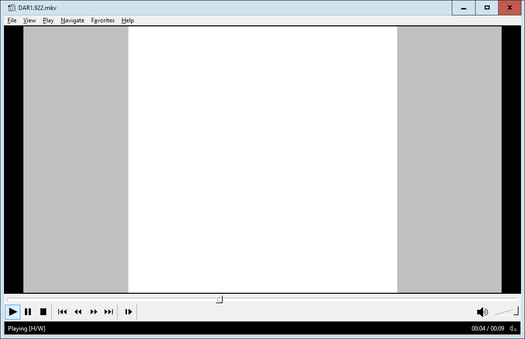

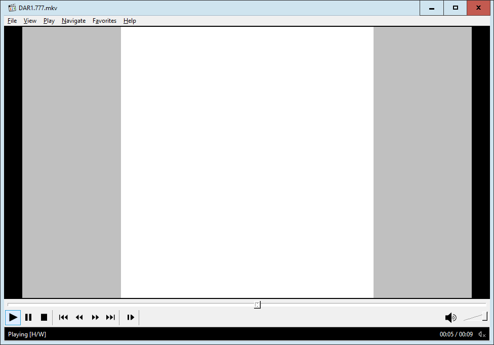

  11. Here's sample 960x540 video with at 16:9 image squashed into a 888x536 portion of the frame. The original was a square pixel encoding so the white block in the center of the frame appeared too tall. I used MkvToolnixGUI to set the display aspect ratio to 1.922. If your player responds to the flag the white block should be square.
    Before setting DAR:
    [Attachment 59955 - Click to enlarge]
    After setting DAR to 1.922:
    [Attachment 59956 - Click to enlarge]
