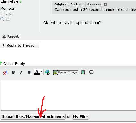

    Ok, where shall i upload them?
    Mar 2008
    Originally Posted by Ahmed79 View Post
    Can you post a 30 second sample of each file, I'd like to test them on my LG TV
    Right here using this button
