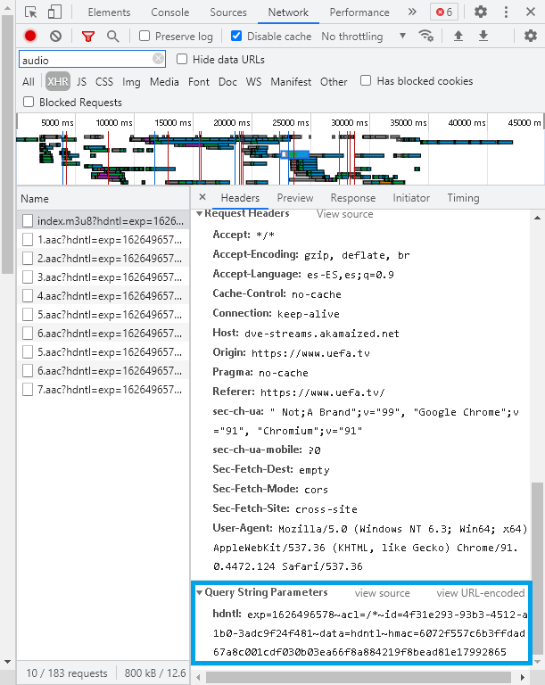

    Originally Posted by tko4 View Post
    Hi all, yesterday I was downloading videos from uefa.tv with streamlink without any problems but for some reason today I get the following error message:
    [cli][info] Found matching plugin hls for URL https://dve-streams.akamaized.net/ns-006/MjAyMQ/NQ/NQ/73b52acf-f6f8-45e3-9c86-998c4fa73912/video/a4d35e7e-9d2f-4ade-919a-46f82d8a0432/index.m3u8?hdntl=exp=1626447482~acl=%2f*~id=14f7c4aa-1119-4db4-8d00-82d459a5f551~data=hdntl~hmac=bb298ca9fd7e657d8812bc358514ca17009e81ebde45cc4333cb262074c439f8
    error: Unable to open URL: https://dve-streams.akamaized.net/ns-006/MjAyMQ/NQ/NQ/73b52acf-f6f8-45e3-9c86-998c4fa73912/video/a4d35e7e-9d2f-4ade-919a-46f82d8a0432/index.m3u8?hdntl=exp=1626447482~acl=%2f*~id=14f7c4aa-1119-4db4-8d00-82d459a5f551~data=hdntl~hmac=bb298ca9fd7e657d8812bc358514ca17009e81ebde45cc4333cb262074c439f8 (403 Client Error: Forbidden for url: https://dve-streams.akamaized.net/ns-006/MjAyMQ/NQ/NQ/73b52acf-f6f8-45e3-9c86-998c4fa73912/video/a4d35e7e-9d2f-4ade-919a-46f82d8a0432/index.m3u8?hdntl=exp=1626447482~acl=%2F*~id=14f7c4aa-1119-4db4-8d00-82d459a5f551~data=hdntl~hmac=bb298ca9fd7e657d8812bc358514ca17009e81ebde45cc4333cb262074c439f8)
    That's because some data are missing.
    To download the video use this code:
    streamlink --http-header "User-Agent=x" --http-query-param "hdntl=x" ".../index.m3u8?hdntl=exp=..." best -o video.ts
    To download the audio (type "audio" on dev tools filter and copy the first link) use this code:
    ffmpeg -user_agent "x" -headers "hdntl: x" -i ".../index.m3u8?hdntl=exp=..." -c copy audio.aac
    You can also find the "hdntl" value there.
    [Attachment 59885 - Click to enlarge]
    And then just merge them with ffmpeg
    ffmpeg -i video.ts -i audio.aac -c copy video.mp4
