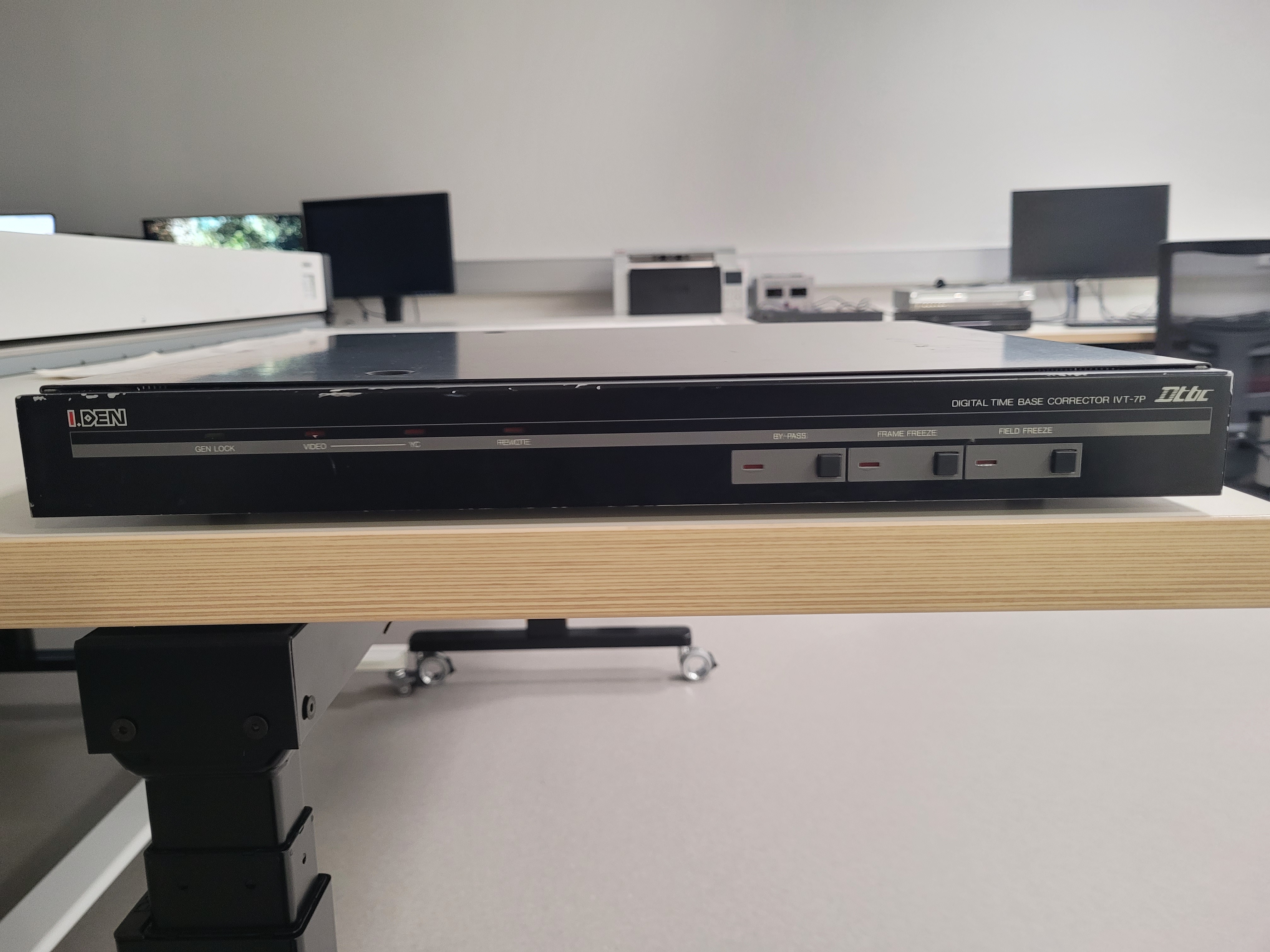

  1. Anybody know anything about this company? Absolutely no information online about them. Particularly trying to find operating manuals for the time base correctors they made: IVT-9SPM, IVT-7P

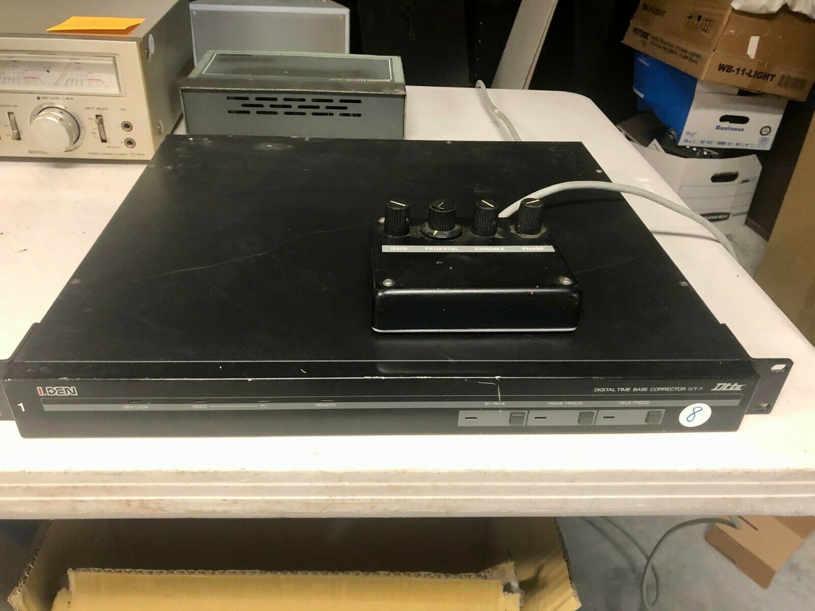

    I have the manual for the IVT-7, somewhere, always forget to scan it.
    The IVT-7 is probably the only rackmount unit that was designed with consumer analog sources as an "also" feature. So it can work, if in good shape. But essentially all of these units have problems, good shape ended years ago. I don't want to get anywhere near them.

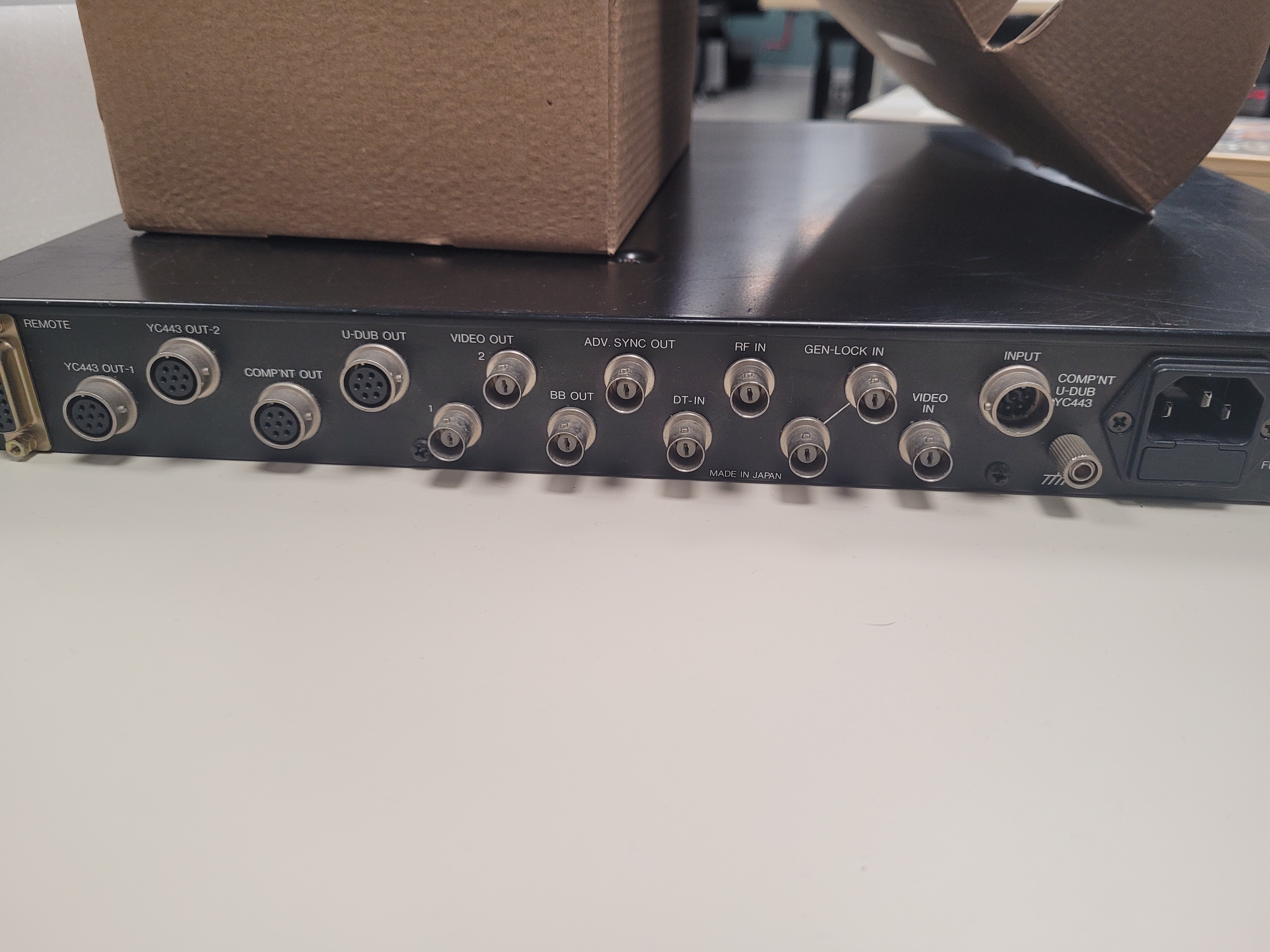

    What interests me most about them is the 7-pin dub i/o that they both have (see image). The IVT-9 seems to have a single 7-pin input for component, yc443 and u-dub (which I assume is umatic dub?) and then separate 7-pin outs for each of these. Not entirely sure how these all function as I don't have the 7-pin cables to test with currently, but hoping it could function as a way of capturing using dub signal from u-matic.

  4. UMatic dub is a bit like Y/C - but instead of carrying the 4.43MHz or 3.58MHz PAL or NTSC chroma subcarrier on a separate pin, it carried the off-tape 'colour under' heterodyned chroma (which is usually around 600-700kHz instead of 4.43 or 3.58MHz). This was designed to improve the quality of 'dubs' (i.e. copies) made - as it avoided a double conversion to and from baseband composite (the concept pre-dated S-video).
    It may be that the IDEN delivered improved decoding quality if you fed it Y/C or Dub and took a Component output from it.

    Yes, aware of the differences between dub and Y/C, but was thinking that this IDEN potentially can convert dub to Y/C443 similarly to how certain DPS transcoders can. But I'm probably just being overly hopeful. Currently working through some U-matic tapes but am keen to avoid using the composite signal if I can. No way to tell until I actually track down some 7-pin cables or just make some myself...

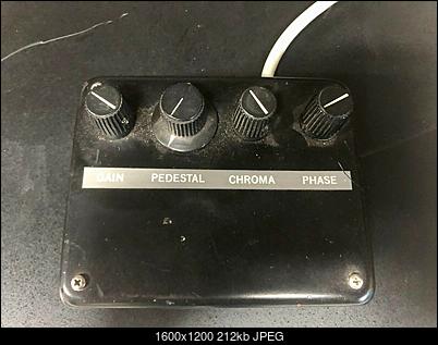

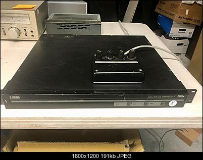

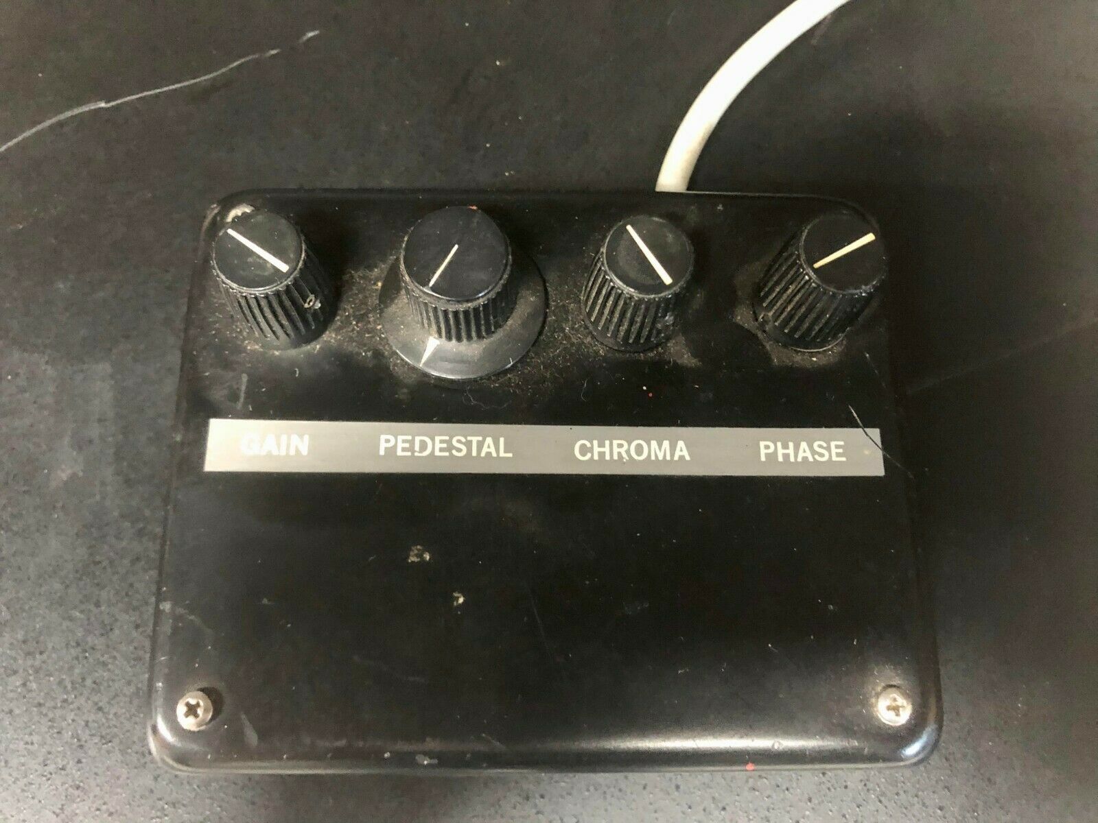

  6. I'm in agreement about avoiding these I.DEN units or really any of the in-period hardware. All these Dub-native TBCs and Dub transcoders all appear to be from the late 80s or so and concerns about the age of the electronics in them are real. Also, that I.DEN IVT-7 unit should have remote with it for the proc amp, as seen here:
