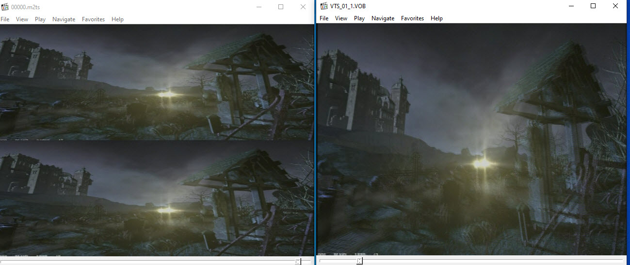

Now that I learned a little bit more with scripting, if I use the simple stack vertical or horizontal scripts on this file (inc the d2v version) the aspect ratio (4:3 in this case- no letterboxing) goes away. It looks more like its stretching and squishing the clip. What would i have to add to the scripts in order to keep the ratio?
Here is a sample of whats occurring (ignore the quality). Pic on left is how it appears using either script and on the right is how it should be displaying. Also ignore the 000.m2ts title name, that is from Tmpg authoring works 6 which will accept avisynth scripts
[Attachment 59837 - Click to enlarge]Last edited by mazinz; 13th Jul 2021 at 16:15. Reason: typos galore
I'm not sure what you're asking here. I see a "normal" interlaced frame on the right (with the usual woven fields). On the left two fields are stacked rather than woven. There are many script mentioned in this thread. What exactly are the scripts that gave you those results? Neither of those would have come from a script with StackHorizontal(). The image on the left could be made from the image on the right with:
Code:SeparateFields() StackVertical(SelectEven(), SelectOdd())

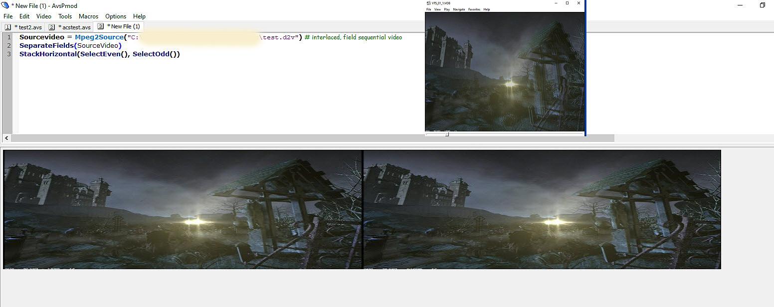

Original goal was to take the FS 3d clip and either convert it to SBS or top/bottom. Yourself and DaveXnet helped me out with what I was doing wrong for the avisynth scripts listed.
However when I finally ran those I noticed the aspect ratio was going off. Cornucopia had a script (listed in post 1) back from 2011 where a user was trying to convert 3d FS and went with top and bottom. That script worked for me but gave me the weird ratio results you saw in post prior.
That said, running your script of
also displays the ratio being off looking more vertically squished and horizontally stretched (similar to how it appeared in Cornucopia's top and bottom script). I am not sure why this is occurring. Is there something that should be added to the script to prevent the stretch and squish? For arguments sake I ran the clip in GSpot just to be sure it was truly 720x480 4:3 and not flagged wrong by the authoring company.Code:Sourcevideo = Mpeg2Source("C:\test.d2v") # interlaced, field sequential video SeparateFields(SourceVideo) StackHorizontal(SelectEven(), SelectOdd())
I have a sample picture taken in avsmod where you can see the script and display results with the picture being stretched and squished. I super imposed (top right in the picture) how the clip should look in terms of display. I also included a short sample clip (cut by smart editing- no encoding) if you want to take a closer look at it. I appreciate the help

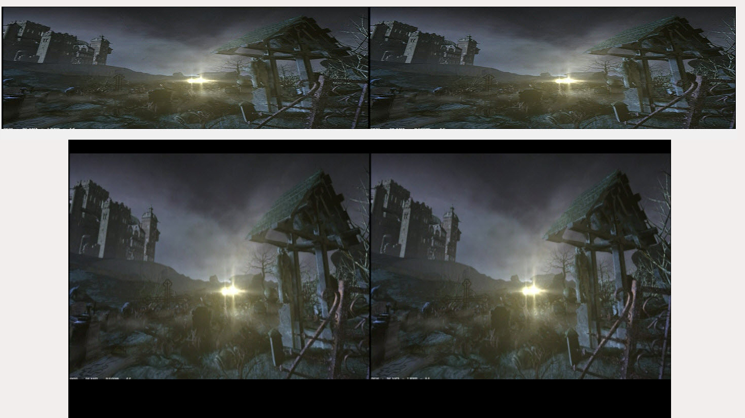

Separatefields produces a half-height picture. NOt sure what you're trying to do or show, to be honest
I'm not sure how much more simple I can make this? I went over what I was trying to do in the post above. Its not so much about half height but that its NOT keeping the ratio when its doing it. Here, the top image is how it displays in the script. The bottom image is how I need it to look (which is shrinking it so it fits side by side while keeping the aspect ratio). The output format is side by side (parallel) 3d which I can then play through my projector which will convert the side by side to my current active 3d format
[Attachment 59856 - Click to enlarge] -
Once you get outside the DVD and Blu-ray standards 3d is a wild west where everyone does their own thing. If your player doesn't play the half height fields correctly you will have to resize them yourself.
You might also have to reverse the order of SelectEven() and SelectOdd().Code:SeparateFields() Spline36Resize(640x480) StackVertical(SelectEven(), SelectOdd()) # or StackHorizontal
THANK YOU Jagabo!! Yes I do have to swap the field start order otherwise the clip would be crosseyed view.
