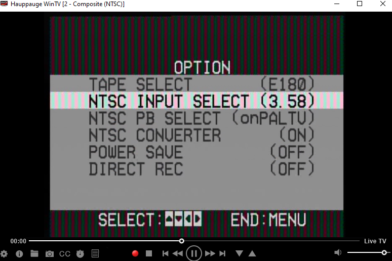

    I've actually managed to get into the setting through WinTv for some reason, I will post a pic below, please tell me if I should change anything, thank you.
Name:	NV-FJ600 VCR Settings.PNG
  9. EDIT since you posted while I was replying: Yes, Change NTSC PB SELECT to "3.58". Can also turn off NTSC Converter but I think that's only for converting ntsc 3.58 from the front input to ntsc 4.43 so probably not relevant.
    On page 16 you can see how to select the NTSC output system (NTSC PB SELECT), which is where you want to chose NTSC 3.58. I have one of the predecessors (NV-HD630AM) which is set up the same way, so I'm pretty sure it should work fine. It shouldn't matter what it is connected to for displaying the menu, though as VCR menus very often are non-standard (240p/288p) signals you may not be able to see it if connected directly to the capture card (but should display if going via the ES10). It could also be that the menu is output as PAL by default, so it may be easier to use a TV for it, though it seems the ES10 will output something even if it's receiving the wrong tv standard so that may be sufficient to change the system.
