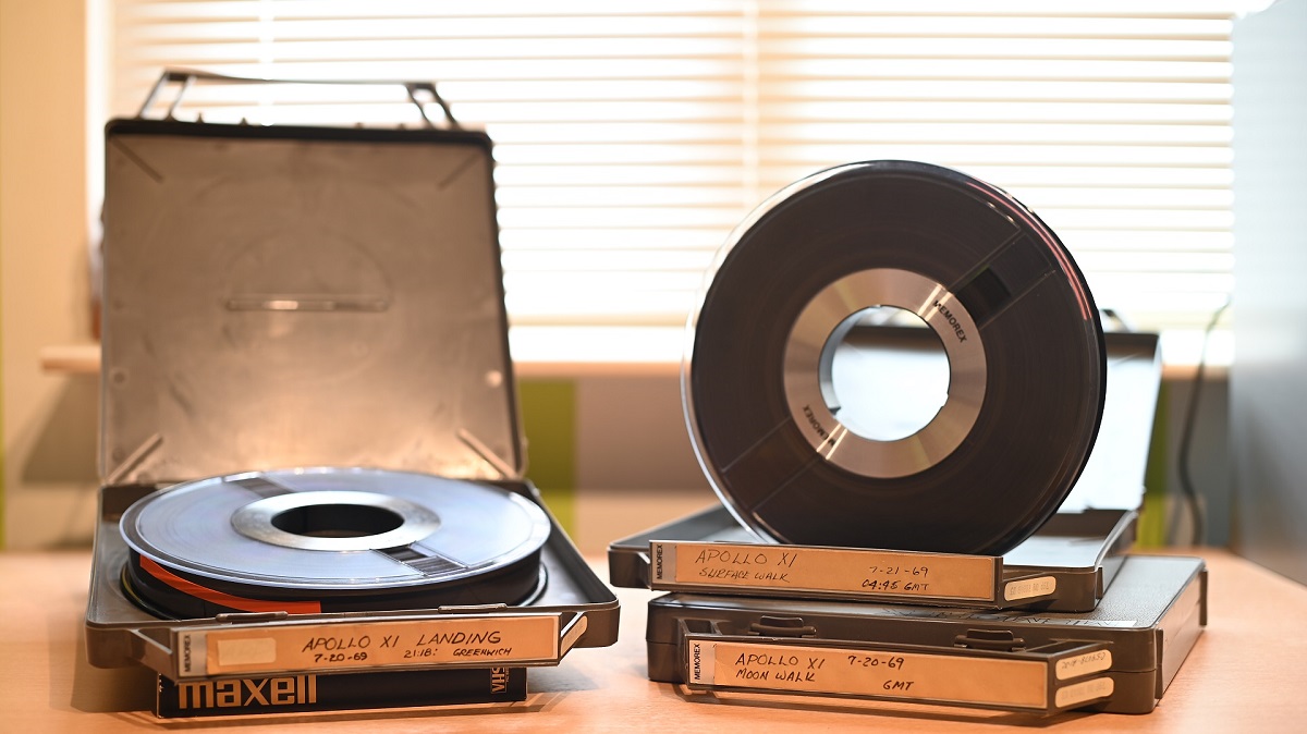

  15. Found someone an hour driving from here that has a type C machine.
    I have been told by a company that a type A tape will have its audio track aligned with the cue track on type C.
    Hoping to get a short piece of each tape played soon. This will allow me to verify the contents on the tape by audio.
    Then I will know if the labels hold true and I can work on shipping to he company.
    Unfortunately no success talking with three companies in the NL that got type A machines. Either stopped replying or not worth it for them to service a machine for just 3 tapes.

  17. Scanning head detail of Michaels' type C machine... with the "Landing" tape threaded.

  20. I got a reply from the video transfer business, they may not want to actually do the transfers because of copyright concerns. The tapes may not only contain the raw NASA feeds, but also network footage and commentary. If the latter is the case they are concerned with the end-goal of the transfers, because technically I would not have rights to any network content.
    I need to know whether they will still send the files even if they ID the content to be from broadcasters after transfers.
    I'm not going to pay 200-300 dollars per tape only for them not to send the files back.

    Regardless, I have been talking with an other company based in the US and asked them about their native capture format and how they can deliver besides h264;
    "Native is normally dvAVI in Priemere.
    We can capture using BlackMagic AVI 10bit YUV for huge files (~100Gb/hour); will need a hard drive that you supply or we supply for $65.
    We can transcode this into ProRes HQ if you want."
    dvAVI seems adequate for capture and delivery?

  29. Originally Posted by Dutchsteammachine View Post
    100Gb/hour is 28 Mbit/s, seems right for DV. So, one hour is 12.5 GB, you don't really need a hard drive for this when you can have a 128 GB SD card for $20.
    DV-AVI is Microsoft's container for DV. I would not call it native, after all what you have is old analog recording. I suppose they ingest analog video through Firewire using some sort of Canopus box, which is why they say that DV is native for them. Wait, they say they ingest as 10-bit via BlackMagic? Why is it only 100 Gb/hr? Maybe it is 100 GB/hr? And then they downconvert it to 8-bit DV because it is "native for Premiere"? But they ask whether dvAVI is adequate for "capture and delivery", hmm. No reason to convert DV into ProRes if they actually capture DV.
    Some users on this forum claim that DV breaks up into macroblocks easily, and that it butchers chroma OTOH, your recordings may be monochrome, so who cares for chroma. DV is well-supported in the industry, so there is some benefit to using it. Apple promised to continue supporting it on the OS level for M1-based Macs.
