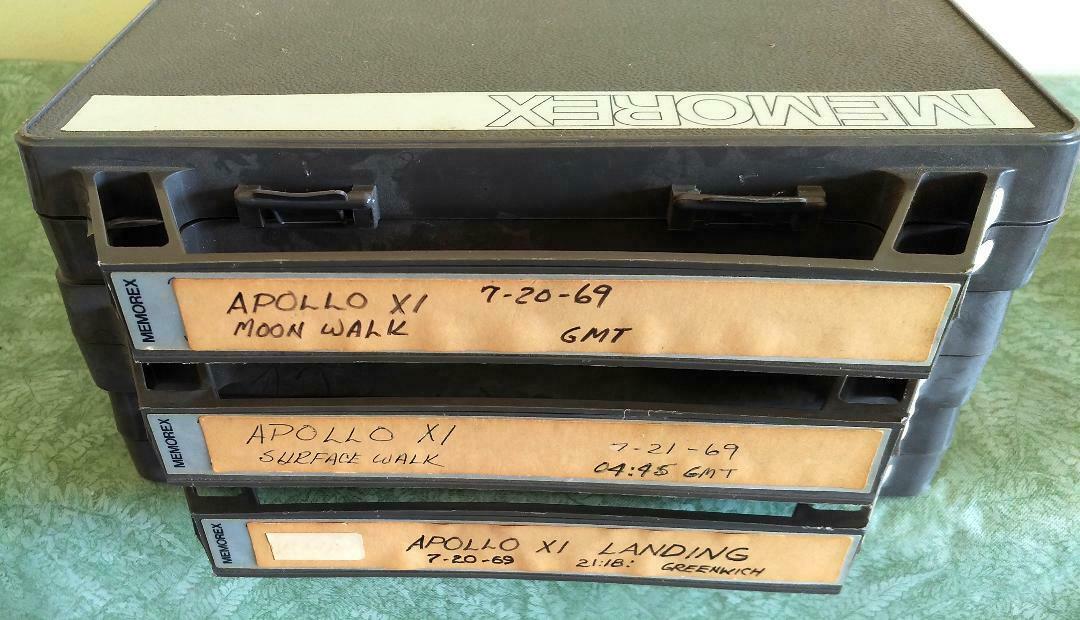

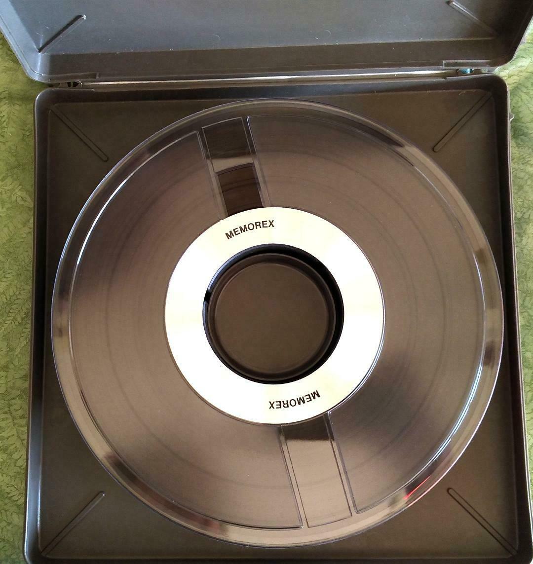

  1. Found these 3 video tapes at an online auction in the USA, they have since been send to me in Europe and should arrive by next month.
    1" tape on a 10" spool.

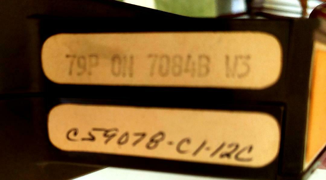

    If we have to go by the case identifier (79P-ON-7084B-W3), they are exactly:
    Memorex Type 79 Series Designed for helical-scan broadcast and closed circuit television recorders.
    Ampex VR-6000 and VR-7000 Series Recorders
    79P-ON-7084B-W3
    62 minutes 9-4/2" Precision Reel 1" x 3000' in Box 1"
    So probably recorded with an NTSC Ampex Type A machine.
    [Attachment 59764 - Click to enlarge]
    [Attachment 59765 - Click to enlarge]
    [Attachment 59766 - Click to enlarge]
    The seller did not have a way to play back the tapes, so nothing is known about their content or which format/machine they were recorded with.
    Neither do I know the condition of the tapes, if they need special treatment before they can be played back and digitized.
    It is a gamble and I am prepared to be disappointed, there could be something different on them entirely!
    If the labels are correct however, the tapes likely contain USA television broadcasts of the missions during the written events. Of the NBC, CBS or ABC. So while unlikely to be lost NASA footage, still very cool possibly live recordings off of TV.
    Problem, almost certainly NTSC! Does anybody know of Ampex Type A NTSC machines in the netherlands/europe/uk? The closer the better.
    Once digitized I can put them on my YT channel, if the TV channel is okay with it.
    Thoughts?

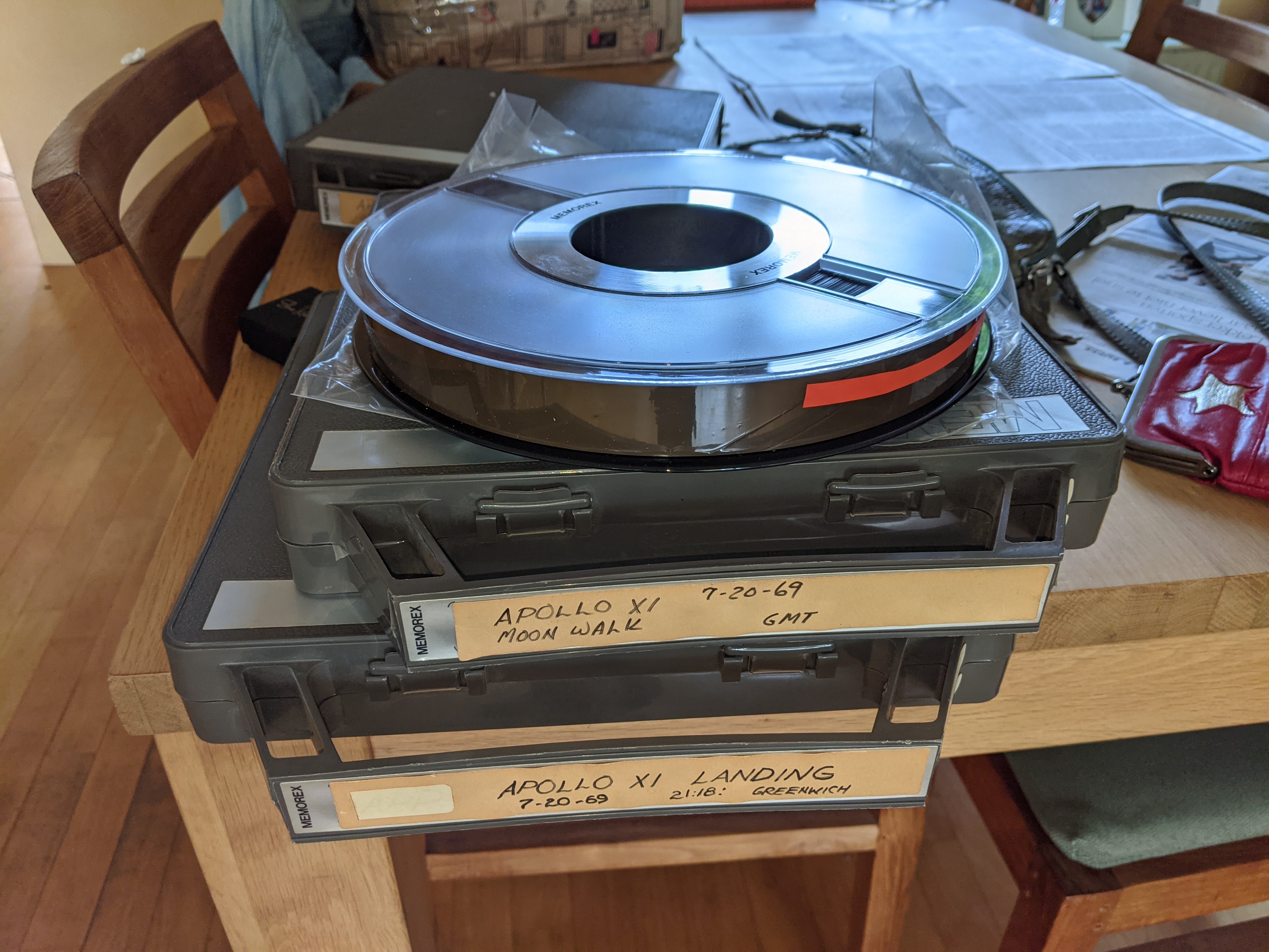

  16. Time for a delayed update!
    The tapes have since arrived at my place. The condition of the tape appears to be good...tape does not fall apart, is clean, does not smell or does not curl/spoke/come off.
    [Attachment 60899 - Click to enlarge]

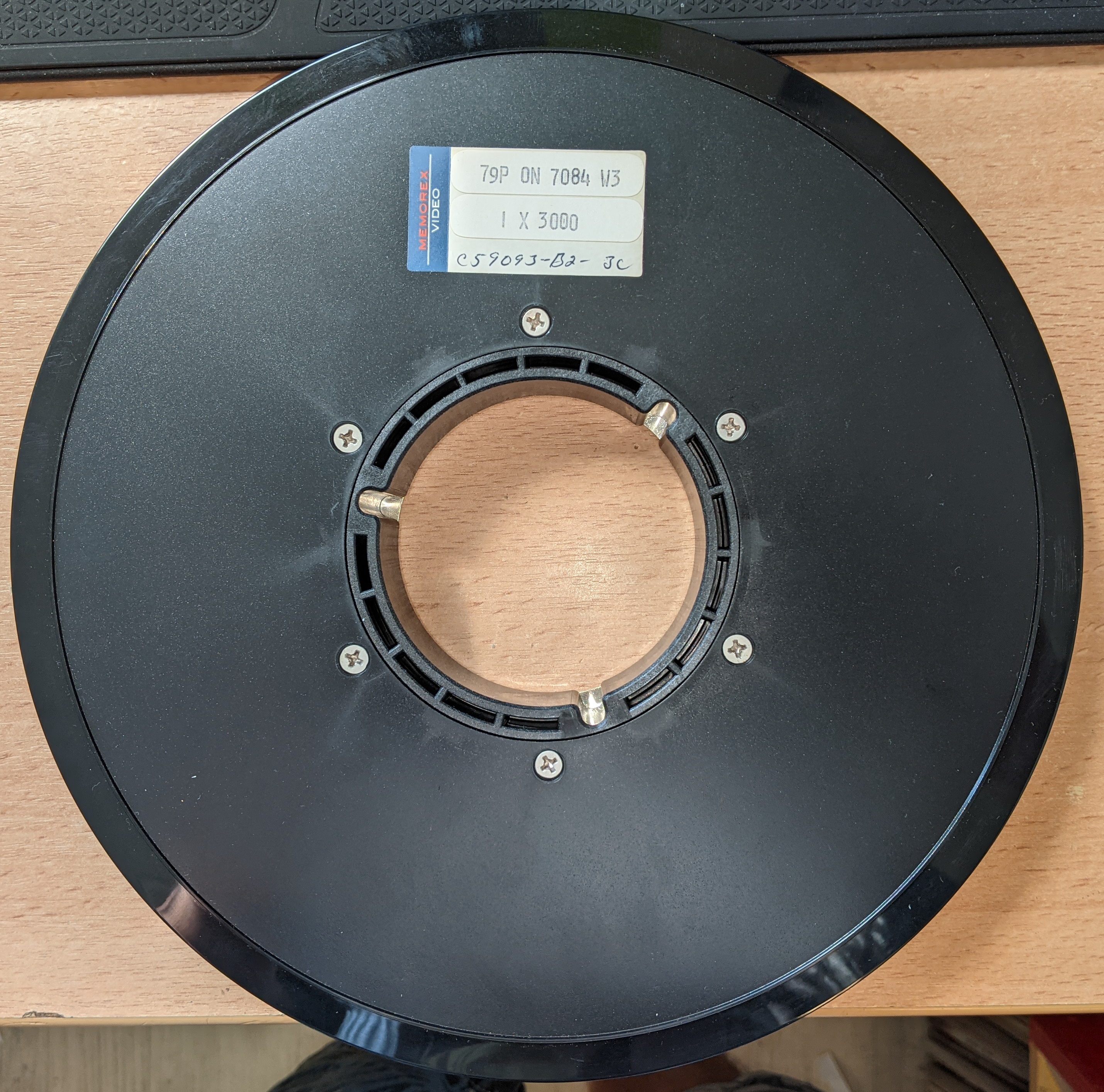

    Furthermore, the reels themselves also bear identification numbers, which correspond to the numbers on the boxes. So there are no random tapes put in the boxes.
    [Attachment 60900 - Click to enlarge]

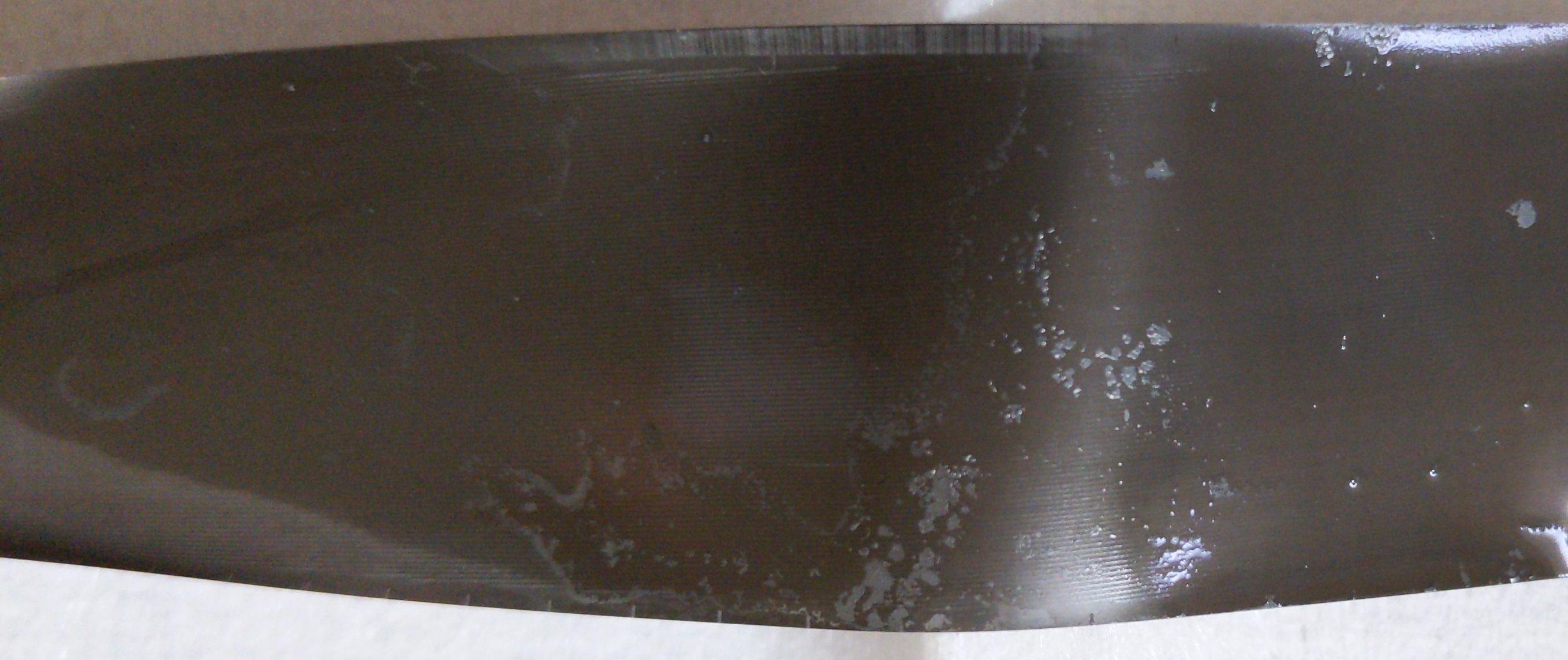

    More good news... see a piece of tape under my magnetic developer:
    [Attachment 60901 - Click to enlarge]
    Clearly visible from top to bottom:
    1. Mono soundtrack
    2. Helical scan video track.
    3. Control pulse track.
    So there is definitely video on them... and most likely Ampex Type A NTSC, maybe PAL.
    I have already found a company in the Netherlands with two Ampex Type A machines. Even if they are NTSC reels, playback on a PAL machine for the sound is possible. Then I can identify if it has NASA material on it, or something else like football or I Love Lucy.
    If they do contain Apollo 11 broadcasts, I think I will be able to identify source from the audio aswel. If they were sourced from NASA, a television channel or a tracking station.
