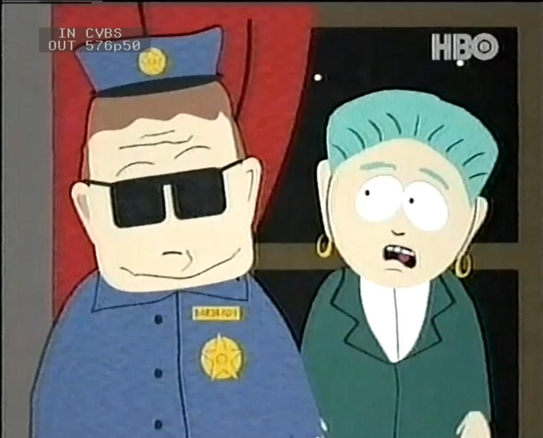

However quite often I get the problem you can see on the attached screenshot named Bad. After a while it switches back to a more desired picture you can see on the other screenshot named Good. It produces this vertical/diagonal fish fin like artifacts and washed out colors on the picture randomly. I tested that it is not the capture device. The converter produces the issue when hooked directly to the TV as well. I got an RMA exchange, but the new converter is doing the same problem.

It looks like a herringbone pattern interference caused by cables/grounding issues
Thanks, maybe this StarTech converter has some grounding/shielding issue. I used the same cables with the AverMedia ET111 it had no such herringbone issue, only other issues
. I think this StarTech might be a bit higher in functions but still far away from a decent solution. It also has an S-Video input I wll try to fidle with that one, maybe that connector is better grounded.
Anyway I know that some may call these composite to HDMI converters a butchery to the video signal, for my needs this StarTech solution (without herringbone) would be an adequate solution for simple PC-less capturing of VHS to mp4.
