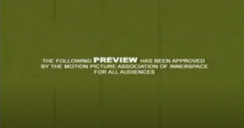

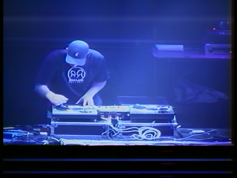

Anyway using the DMR-XS350EBK is a no go especially when recording NTSC tapes, take a look at these pictures the top on is using the DMR-XS350EBK as a passthrough device which also reduced the actual sound recording level quite a bit, the bottom picture is without the DMR-XS350EBK.
Even though it has left a straight line across the recording the picture looks brighter to me
[Attachment 60094 - Click to enlarge]
This one is without the DMR-XS350EBK no ghosting line but picture is slightly darker
[Attachment 60095 - Click to enlarge] -
Is that a NTSC or PAL recording? It looks a bit like NTSC (or PAL60 from a PAL VCR playing back NTSC) with capture card and/or dvd-recorder set to NTSC as it looks like there is a bunch of garbage at the bottom.
I don't know what would cause the line, is it moving up/down or is it stationary? (Could be some 50hz noise or grounding thing)
Brightness being boosted is a thing on older panasonics too, the AGC tends to brighten a bit too much unless you manually lower the signal level in some way. -

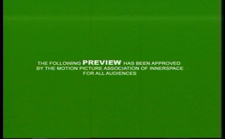

Yes oln it's an NTSC tape, if you read what I have used in the top post you will see what I have tried.
There is no capture card involved I am using a Lite-on 760GX HDD to record. I am not bothered about the garbage at the bottom that can be cropped because the end result of the recording is 720x480 when I have cropped the garbage out. It's the ghosting line near the top this one it's a steady line and it's only doing it with NTSC tapes when recording PAL it's fine. It was just a test mate but I do actually like the way it's worked in some way because it's made it cleaner and picture looks much brighter.
[Attachment 60096 - Click to enlarge] -

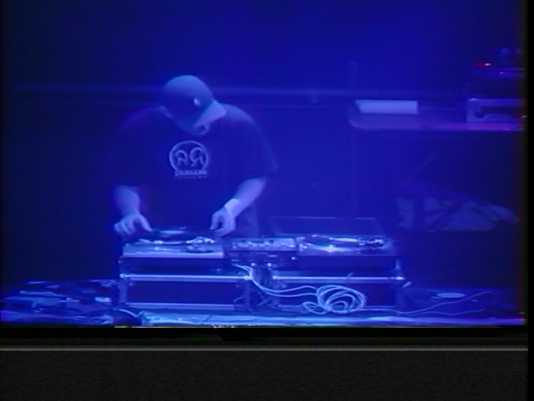

This is the same tape using the same FS200 straight into the Lite-on machine
[Attachment 60107 - Click to enlarge]
Now this is going through the DMR-XS350EBK
[Attachment 60108 - Click to enlarge]
the colours are much cleaner and brighter so it does work but leaves a ghost line on all NTSC recordings. I have just remembered something though I might try because I never turned off the TBC on the FS200 when recording this might be the problem it might not but I will give it ago tomorrow sometime.
I haven't seen any delay at all in any of the videos I have tested mate the only downsides are the ghosting and a lower level of sound recording, like I said it's only a test I won't be using the DMR-XS350EBK just thought I would give it a test see if it made any difference and it did but not what I wanted. -
I mean on the DMR-XS350EBK, you have to set it to NTSC for it to handle NTSC input properly (though I don't know if it properly supports the pseudo-NTSC signal the FS200 will output, at least the older panasonic dvd-recoders only support standard NTSC). I guess it does at least show that it has similar line-TBC/Jitter correction to other panasonic DVD-recorders.
The TBC on the FS200 only works for PAL afaik, so it doesn't matter if it's turned on or not on a NTSC tape. -
