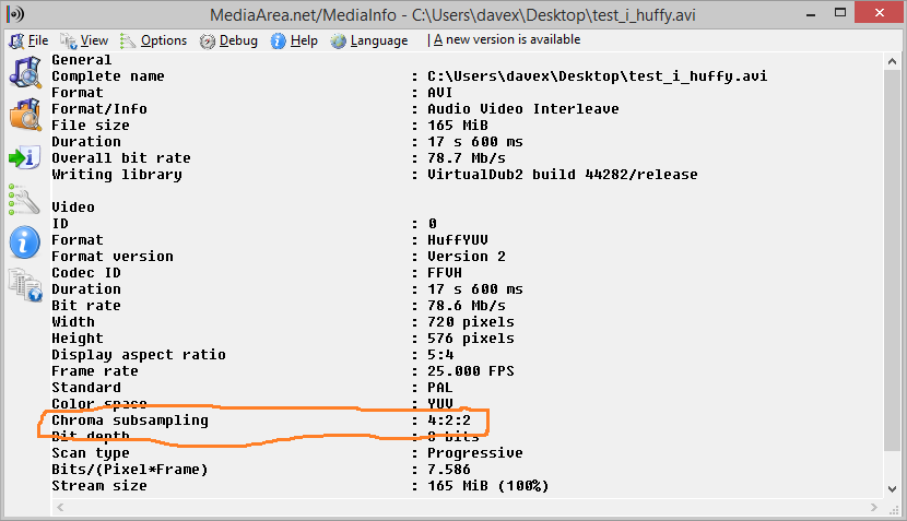

    You should be able to double rate de-interlace in Vdub2 and encode to H264.
    First verify that your Huffy source is Chroma 422 (by using mediainfo)
    Open the source in Vdub2, video/filters/deinterlace
    select interlace mode/interpolate using Yadif - double frame rate (either top or bottom field first. You can verify the correct choice
    by using the right arrow key to step forward frame by frame in a section showing some steady movement. If you see a strange back and
    forth movement change the field order)
    Setup the encoder and save the video as normal (may have to correct the aspect ratio depending on particulars of the source)

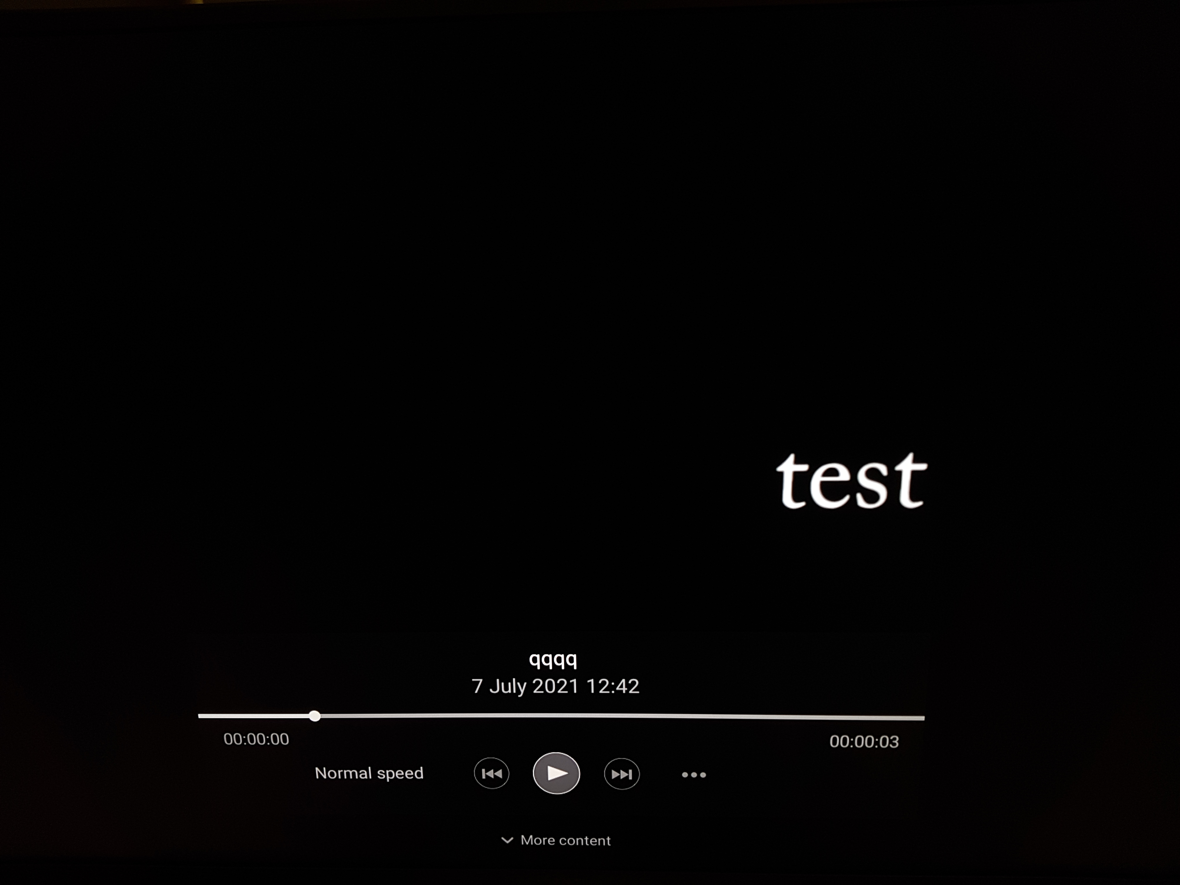

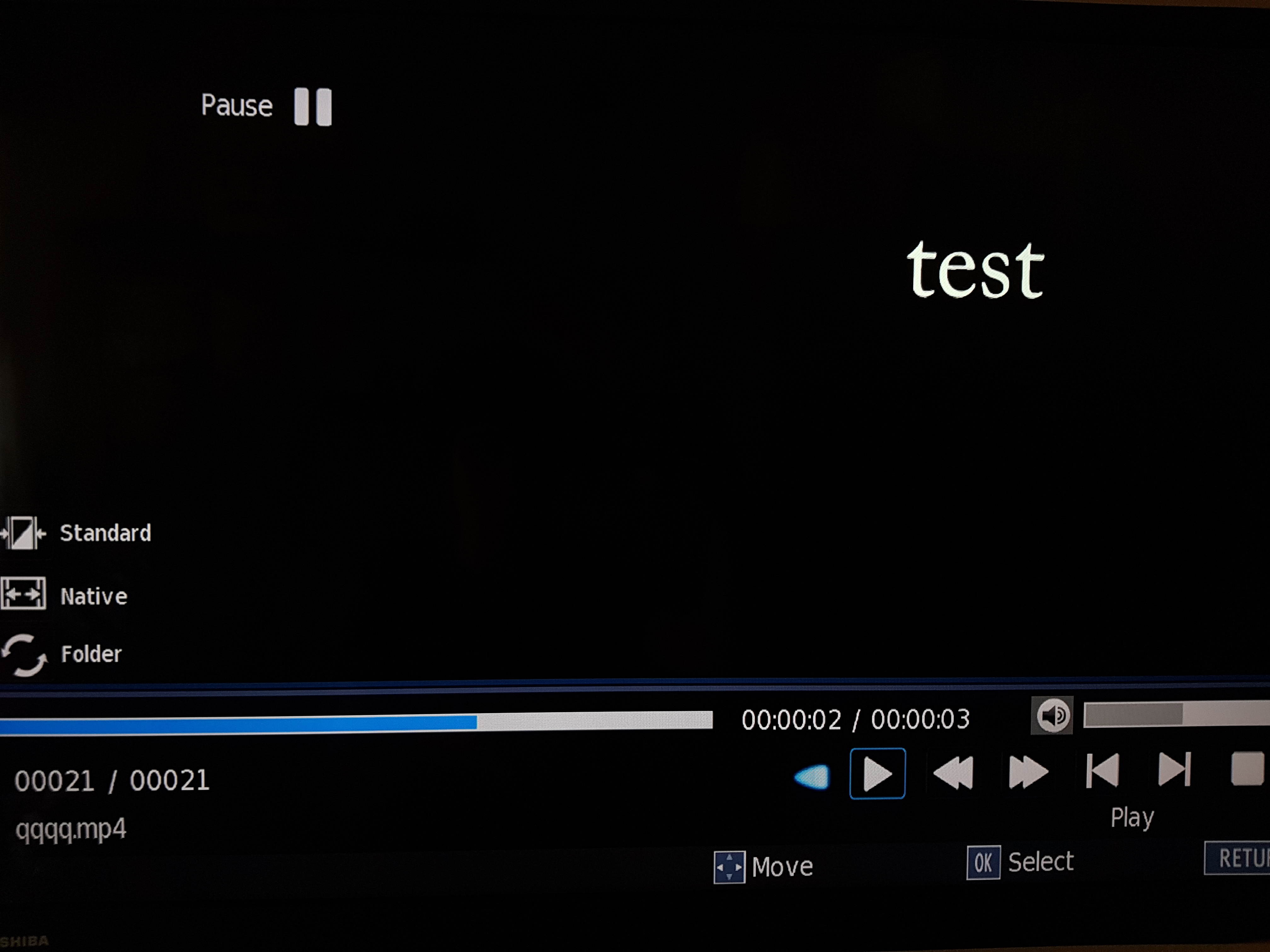

    also have you tried encoding the video in interlaced h264? I've tried and both of my TVs seem support them
    [Attachment 59733 - Click to enlarge]
    [Attachment 59735 - Click to enlarge]
    [Attachment 59736 - Click to enlarge]
    Also deinterlacing seems to improve as the years pass by. Cheap 2011 tv blended fields, mid-range 2014 model removed half of them and BRAVIA from 2020 did a solid job interpolating them (better than any virtualdub filter ever could). bbmaster123 states that he has 30 tapes and 4k television. I can't even imagine how long would it take to process all of them using QTGMC when 3 minute promotional clip takes nearly 20 minutes to finish
  22. also have you tried encoding the video in interlaced h264
    I did and its working now, its seems on this one tape I must've rendered it out as BFF but assuming all my files were TFF that's how I tagged it during encode, causing the tv to screw up the image. Once I figured that out, it played well
