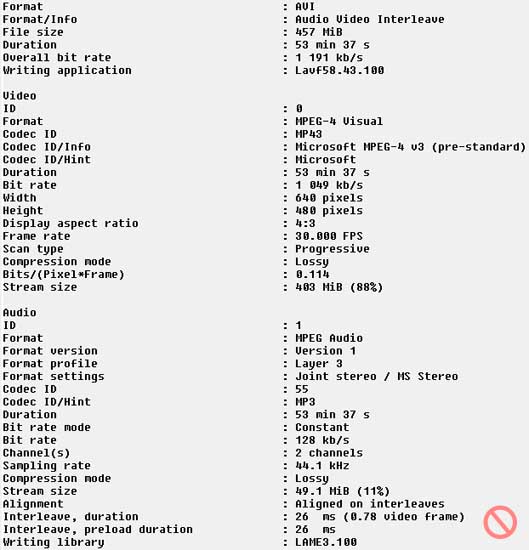

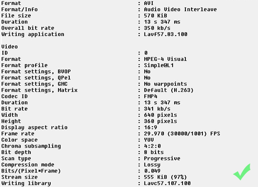

A sample AVI file i acquired online works just fine. Its attributes are documented in the image below:

On the contrary, my conversion software (MiniTool Video Converter) produces a AVI variation that is not being played back, even though sound can be heard:
[Attachment 59688 - Click to enlarge]

Main difference I see is that the first one uses Standard MPEG-4 ASP and the second some old pre-standard (in this case this means not standard conform) video.
-> use another software or if the software allows it another encoder like XviD or DivX which is MPEG-4 ASP conform.users currently on my ignore list: deadrats, Stears555, marcorocchini -
@ProWo: you should at least tell him how to configure that tool to be compatible with the first clip since the standard settings are probably not.
