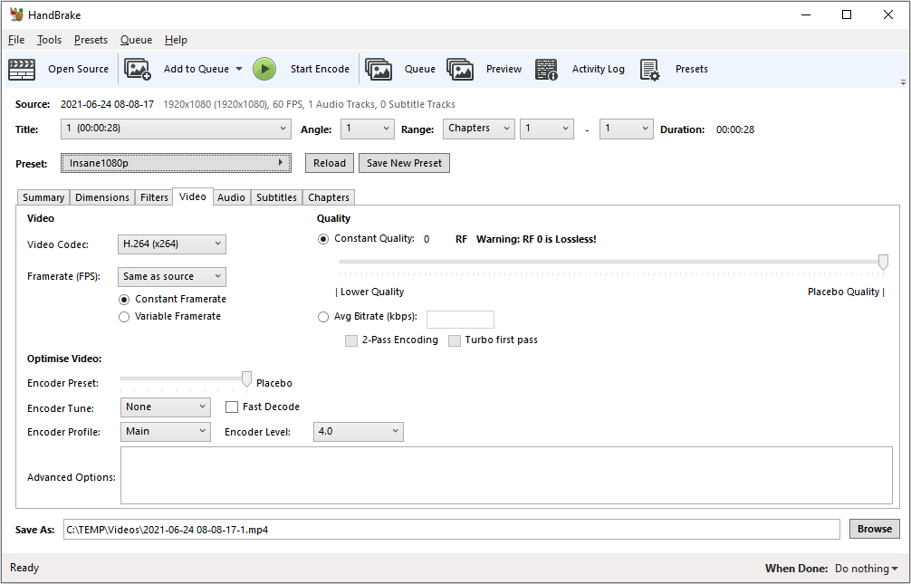

    Anyway, so I fired up Handbrake, and hearing that YouTube tends to prefer x264, while using other codecs tend to result in being re-encoded worse, I made a profile specifically designed to try to encode it as excessively in x264 as possible:
    https://forum.videohelp.com/images/imgfiles/FxpSolR.png
    (Yes I know that’s just a few seconds, it was a test video in that screenshot)
    After about 4:30 hours I ended up with….. a surprisingly small 5.76GB file. Quality was not really too great, it was passable, but scenes with fast movement and many bright particles and effects took a huge hit on the quality.

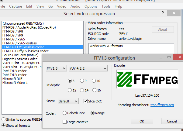

    Or use vdub2 and set compression to FFv1 chroma 422 or 420

    It depends on what options you set in the codec. For 8-bit @ 422 chroma I get approx 10:1 size reduction RGB > FFV1
