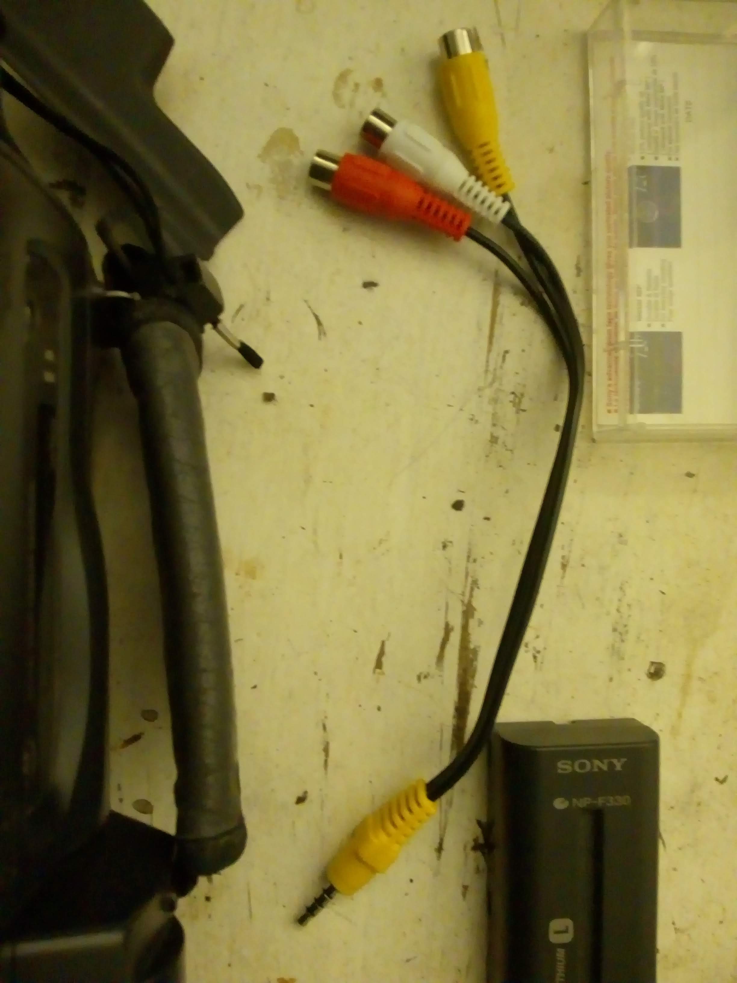

    Attached photo of the cable that is not the original, it is a mini plug to RCA

    Those cables are not standard, every manufacturer have their own location of the pins, possibly that noise is because you are feeding the composite signal into one of the audio channels, get the right cable first.
    I think yes, I have to get the original cable. but the problem still persists that the tapes are not played. Could it be that the wrong cable and its use damaged the video camera?
