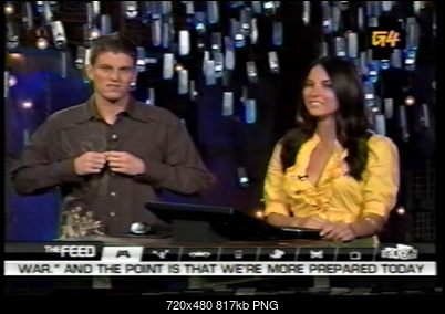

    I'm editing a tape transfer through AviSynth, some frames look like this.

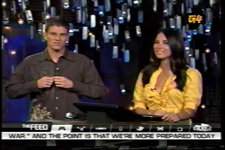

    I know how to fix it with a simple
    SeparateFields() e=SelectEven().crop(0,0,0,-1).AddBorders(0,1,0,0) o=SelectOdd() Interleave(e,o) Weave()
    or
    SeparateFields() e=SelectEven().crop(0,1,0,-0).AddBorders(0,0,0,1) o=SelectOdd() Interleave(e,o) Weave()

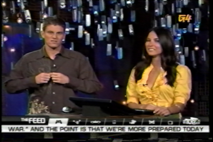

    However, this is a long and painful process. All this and I'm not even a minute in with this project :P
