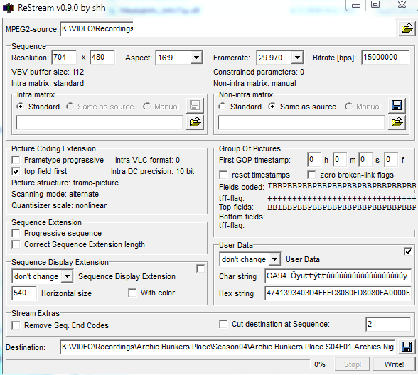

    I have been capturing a standard definition over the air broadcast (HDHomeRun -> NextPVR) which gives me a .ts file (704x480 29.97fps, MPEG-2 video, AC-3 audio). The problem is that the local station has the aspect ratio wrong. I have contacted them and the engineer agreed that it wasn't correct, but never did anything about it. It is an old sitcom that was 4:3. It is broadcast with the aspect ratio flag as 4:3 and so it takes the 4:3 with black bars and further squeezes it to add more black bars. Thankfully I found an easy and free solution, in ReStream. I simply load the file in ReStream, change the aspect ratio from 4:3 to 16:9 and I don't touch anything else. The result is perfect aspect ratio.
    I then use either Smart Cutter (sometimes doesn't cut on the correct frame or has audio sync issues) or Womble MPEG Video Wizard DVD to edit out the commercials. The resulting .ts is then converted to an .mkv file (x265, aac audio) with Handbrake (VidCoder)
    I have watched these videos and maybe 8 or 9 times in each of the 25 minutes video there will be some momentary blockiness, a slight pause, or an audio glitch sound. I have kept each file (original, ReStream output, Womble output, and the final mkv) and have found that the original file is always fine a few of the glitches first showed up in the ReStream output file. This surprised me since I think it only edits the header.
    Is there anything I could be doing in ReStream that is causing this? I have included what the ReStream window looks like before I save it. Are there any other tools out there that can change the aspect ratio for me? Or would I be better keeping it in the wrong aspect ratio until I do the encoding with Handbrake?

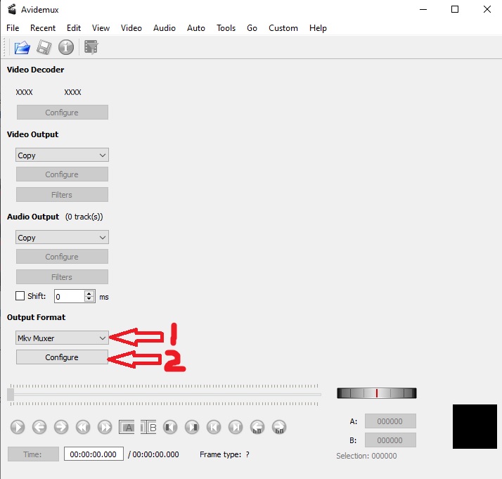

    Also, is there a better tool to use for cutting out the commercials?
    Use Avidemux (free) to remove commercials. Drag and drop the .ts video file into the app. ONLY use the up + down curser keys to travel back and forth along the video - don't grab the slider with the mouse.
    [Attachment 59545 - Click to enlarge]
    - then you will be solely on i-frames keeping the video/audio in sync - and use the A+B markers for start and end of commercial break you want to cut and hit DEL. Do as many times as you want along the timeline of the video, and click
    1- 'Output format' from the drop down box required > SAVE.

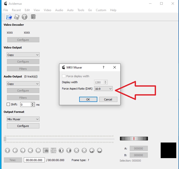

    2- You can force 16:9 AR in Avidemux too as part of the 'Save'.
