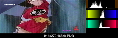

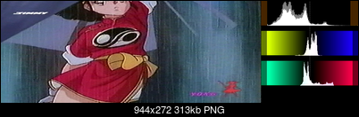

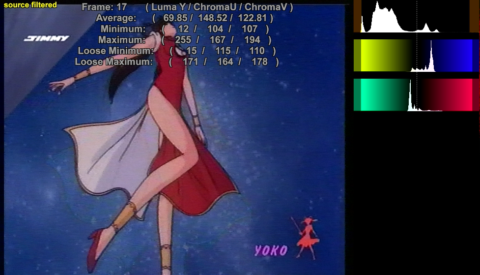

    It is not because the interlaced nature of the video. I suspected that some time ago as well, but a field analysis shows same pattern:
    top field
    bottom field

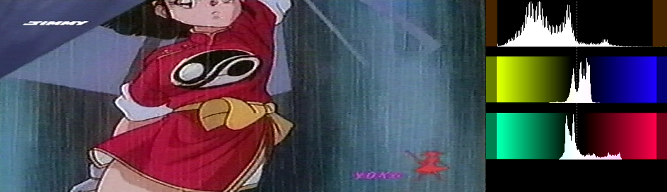

  2. This is what I get from your screenshot. The histogram looks more "normal".
    [Attachment 59775 - Click to enlarge]
    Is your video signal Composite or S-video? Can you upload a short clip of your video?

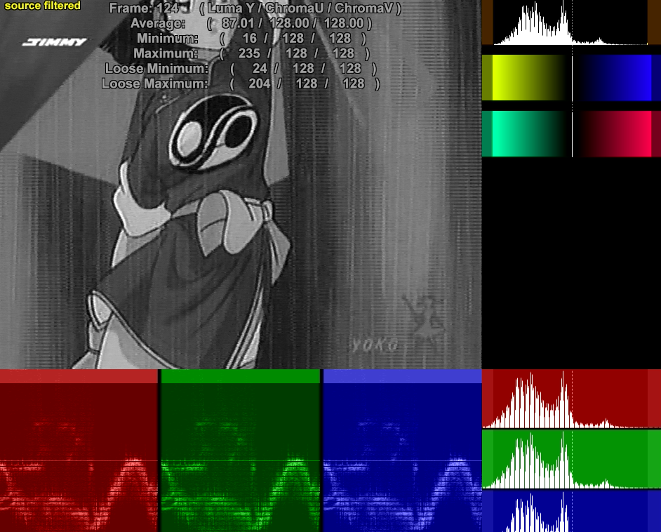

    On the other hand I think it is possible to find a gain (contrast tweak) which will materialize as an integer rounding such that every other level step is affected which results in the "unusual" peaks pattern.
    Edit2, for what it's worth:
    When we grayscale the image (forcing R=B=G or Cb=Cr=128) and inspect the RGB Histogram we see the gaps in the waveform and in the Histogram (RGB format at the bottom)
    [Attachment 59778 - Click to enlarge]

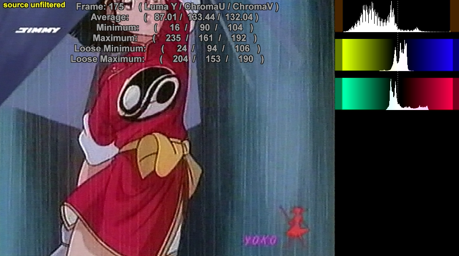

    Here 2 samples, from the same recording captured with JVC HR-S9500MS -> S-Video -> Hauppauge USB-Live2 at default proc-amp setting and HuffYUV.
    It's a raw unprocessed capture.
    The second has a standard field distribution (i.e. not interlaced, coming from the same moment in time), the first is a little weird in its temporal data.
    sample1
    spike1.avi
    sample 2
    spike2.avi

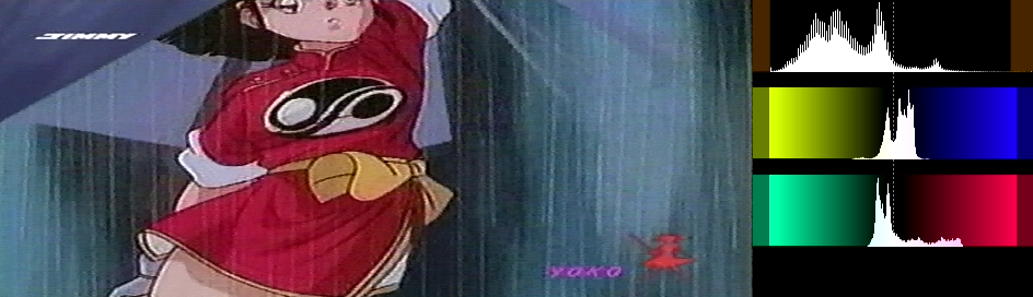

  4. Adding a tiny bit of grain 'smooths' the histogram
    addgrainC(1)
    [Attachment 59779 - Click to enlarge]
    or you may increase the contrast by 1.007 to redistribute the levels
    Tweak(cont=1.007, coring=false, dither=true)
    Uhm.... I suspect then that the histogram for the single channel is of "gap type" as it should be according to skiller remarks, and then combining the full YUV (or RGB) may create the strange saw-tooth pattern. Thanks for the good hint!
  8. Originally Posted by lollo View Post
    We were just trying to understand the source of it
    Scaling and integer rounding (quantization error).
    Take the numbers 16 ...... 235 and multiply with say 1.2 or 0.8, then round to integer and see how certain values get dropped and others accumulate.

  18. Originally Posted by lollo View Post
    This would produce the gaps and the spikes, sure. But I still do not understand the spiky saw-tooth pattern on top of a distributed levels without gaps. My limit maybe.
    It happens when you decrease the contrast or gain. For example say you decrease the gain by a factor of 2/3.
    before	after (truncated)
    100	66
    101	67
    102	68
    103	68
    104	69
    105	70
    106	70
    107	71
    108	72
    109	72
    You can see that pixels with Y values of 102 and 103 have both mapped to 68 -- so there will now be a histogram peak at 68. The same happens at Y=105 and 106, both become 70. You get regularly spaced peaks from the integer rounding (or truncation)
    Here's an AviSynth script that shows the gaps and peaks from integer rounding:
    function GreyRamp()
       BlankClip(color=$000000, width=1, height=256, pixel_type="RGB32")
       StackHorizontal(last, last.RGBAdjust(rb=1, gb=1, bb=1))
       StackHorizontal(last, last.RGBAdjust(rb=2, gb=2, bb=2))
       StackHorizontal(last, last.RGBAdjust(rb=4, gb=4, bb=4))
       StackHorizontal(last, last.RGBAdjust(rb=8, gb=8, bb=8))
       StackHorizontal(last, last.RGBAdjust(rb=16, gb=16, bb=16))
       StackHorizontal(last, last.RGBAdjust(rb=32, gb=32, bb=32))
       StackHorizontal(last, last.RGBAdjust(rb=64, gb=64, bb=64))
       StackHorizontal(last, last.RGBAdjust(rb=128, gb=128, bb=128))
    function cont(clip c, int gain)
       ColorYUV(c, cont_y=gain)
    GreyRamp()
    Trim(0,100)
    Crop(64,0,-64,-0).PointResize(512,512)
    ConvertToYV24(matrix="PC.601")
    Animate(0, 100, "cont", last,-100, last,100)
    AddBorders(4,0,4,0) # so the histogram stays the same scale
    Histogram(mode="levels")
    ConvertToRGB(matrix="PC.601")
    From frames 50 to 0 you get peaks as the contrast is decreased, from 50 to 100 you get gaps as contrast is increased.

    It's then probably the gain, meaning the AGC (automatic gain control) embedded in the capture card, the reason for the strange histogram, more than the levels (brightness/contrast) adjustements (that I did not touch in capture). Thanks!
    Edit: but now, skiller's theory (gaps=no lost data, spikes=data loss, if I did understand correctly) is in danger!
  20. Originally Posted by lollo View Post
    It depends how one defines the "loss". If we have a lower number of different level steps (=coarser quantization, less bits) the quantization error (difference of precise value vs quantized integer truncated value) becomes larger and the (local) SNR drops accordingly. This inaccuracy and reduced number of levels can be seen as a loss (less details). Therefore it is not recommended to squeeze the histogram unnecessarily.
    In jagabo's "before" we have 10 different steps (100....109). In the "after" there are only 7 distinct levels (66....72). What we visually "loose" in this case is contrast.
    On the other hand the empty codewords (gaps) introduce banding, which is however not a "loss" but rather an unexploited potential.
