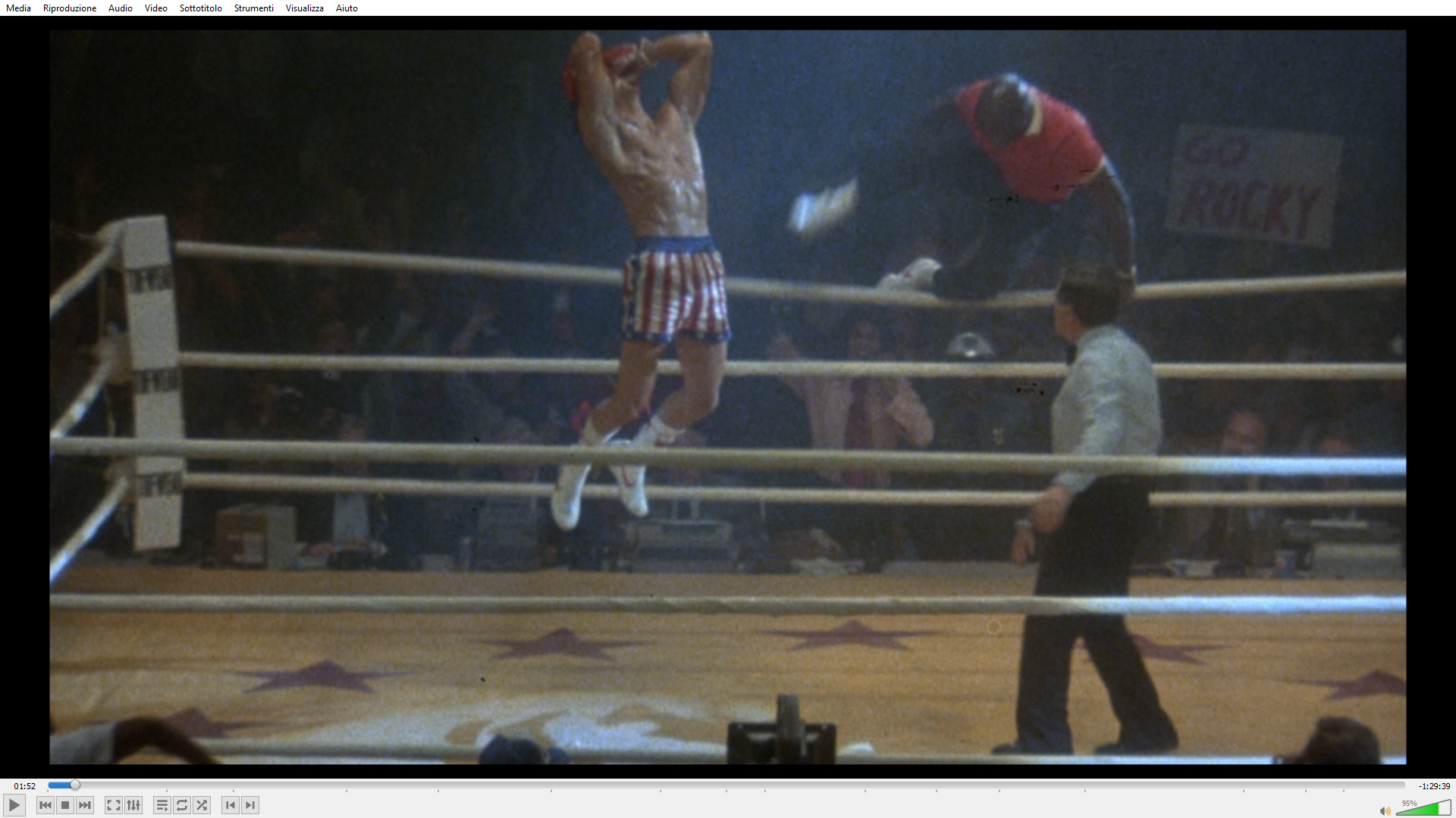

    Unfortunately some blu ray (expecially when the movie is old) are mastered with bad quality. Here an example:
    [Attachment 59482 - Click to enlarge]

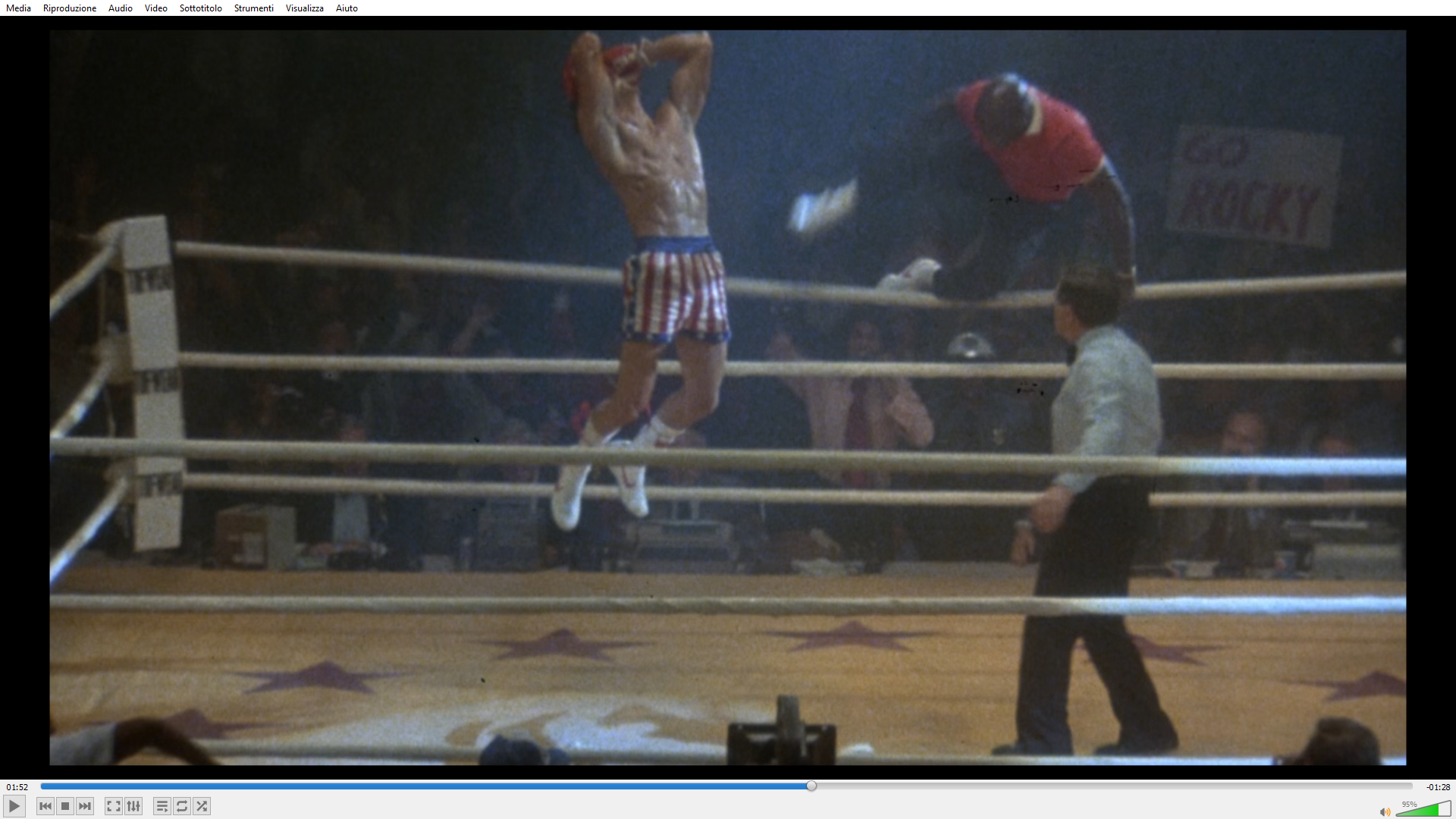

    In the most optimistic situation the compressed file quality is identical to source like in my case:
    [Attachment 59483 - Click to enlarge]

  2. That look like upscaled SD, not HD. Try something like:
    -vf scale=iw/2:ih/2,hqdn3d=4.0:3.0:6.0:4.5
  3. Thank you !! with your suggest the image have more quality:
    [Attachment 59485 - Click to enlarge]

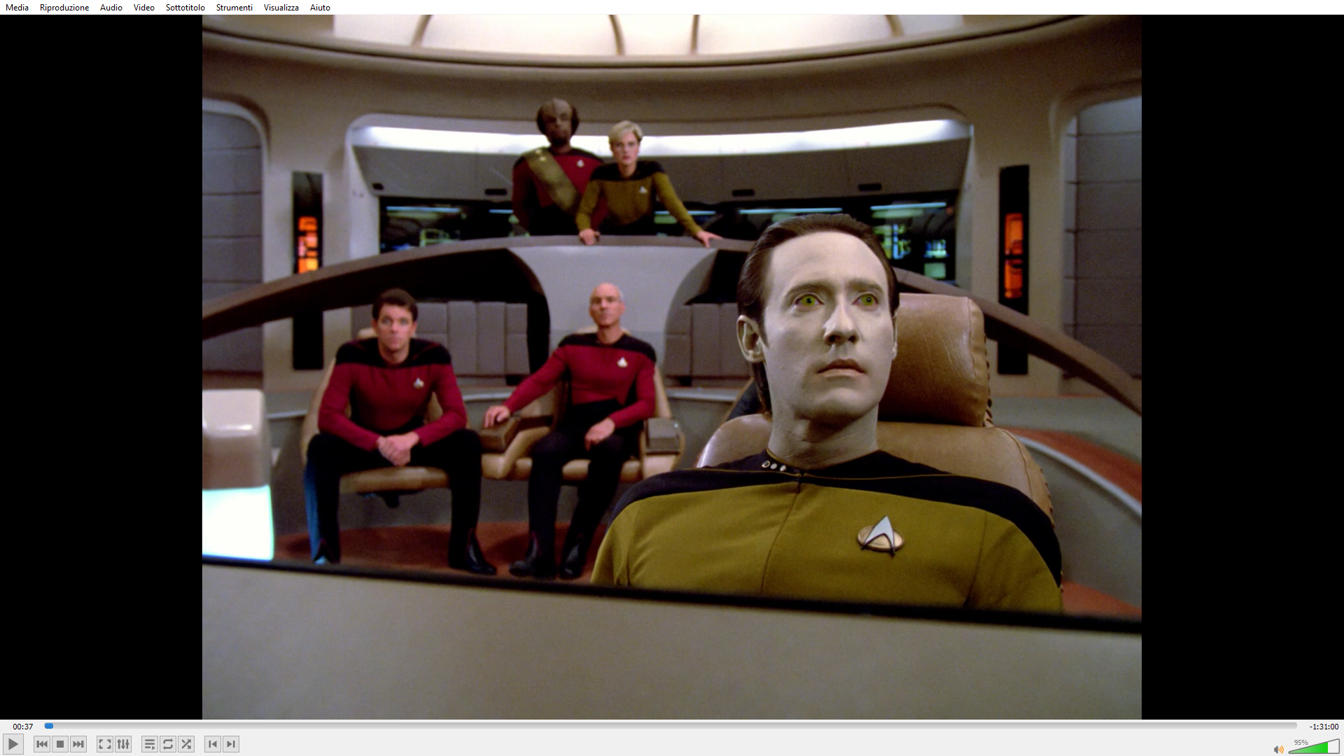

    I have another movie ripped from blu ray where the quality is not bad but I think can be better:
    [Attachment 59486 - Click to enlarge]
    can you suggest another filter to improve it ?
    Thanks !
  4. You need to provide video samples for any substantial filtering suggestions. In general, removing grain risks generating posterization artifacts with 8 bit video. If you're going to remove noise I recommend filtering in 10 bits and encoding with 10 bit x265. Assuming your playback devices support that.

  7. Try something along the lines of:
    ffmpeg -y -i original.mkv -pix_fmt yuv420p10le -vf crop=1440:1080:240:0,hqdn3d=2.0:3.0:3.0:4.5 -c:v libx265 -preset medium -profile main10 -global_quality 20 output.mkv
    I lowered the noise reduction setting so everything looks a little more natural.
  8. The result is excellent !! compliments !!
  9. Oops, that "-global_quality 20" setting isn't doing anything with x265 -- it was for another encoder (I was copy/pasting from other batch files). Use "-crf 28" instead with x265. Lower values of N get higher quality (and larger files), higher values get lower quality (and smaller files). 28 is the default.
    After changing to -crf N I realized that you will probably want to go back to higher settings for hqdn3d and lower crf values. Try:
    ffmpeg -y -i original.mkv -pix_fmt yuv420p10le -vf crop=1440:1080:240:0,hqdn3d=2.0:3.0:6.0:4.5 -c:v libx265 -preset medium -profile main10 -crf 25 output.mkv
    A good section of the clip for testing is from about 32 to 38 seconds into the clip. Try different fhqdn3d settings and crf values on that section. Watch the detail the headrest behind Data's head, and the noise in the shadow there. Also watch the small low contrast details on Data's head when it moves (wrinkles, rough skin, etc.). If you filter too much they will disappear when his head is moving, then reappear when it stops. Or just disappear altogether. You want to strike a balance between loss of those real details and reducing noise.
