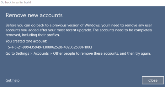

I've been rolling back every Windows 10 update since December 2020 to keep my capture device from glitching, but today my computer installed an update that I cannot roll back after my logging in post-update created a cryptic "user account" preventing me from rolling back the update.
[Attachment 59481 - Click to enlarge]
I have researched and found no obvious way of removing this "user". This rollback issue is probably better suited for a Microsoft forum, but alas it is the catalyst for my cry for help here. Windows 10 only allows a limited time to restore an earlier build, so I have 10 days to figure out how to roll back the update, or else I am stuck with stuttering USB capture and I will have to put my project on hold indefinitely.
