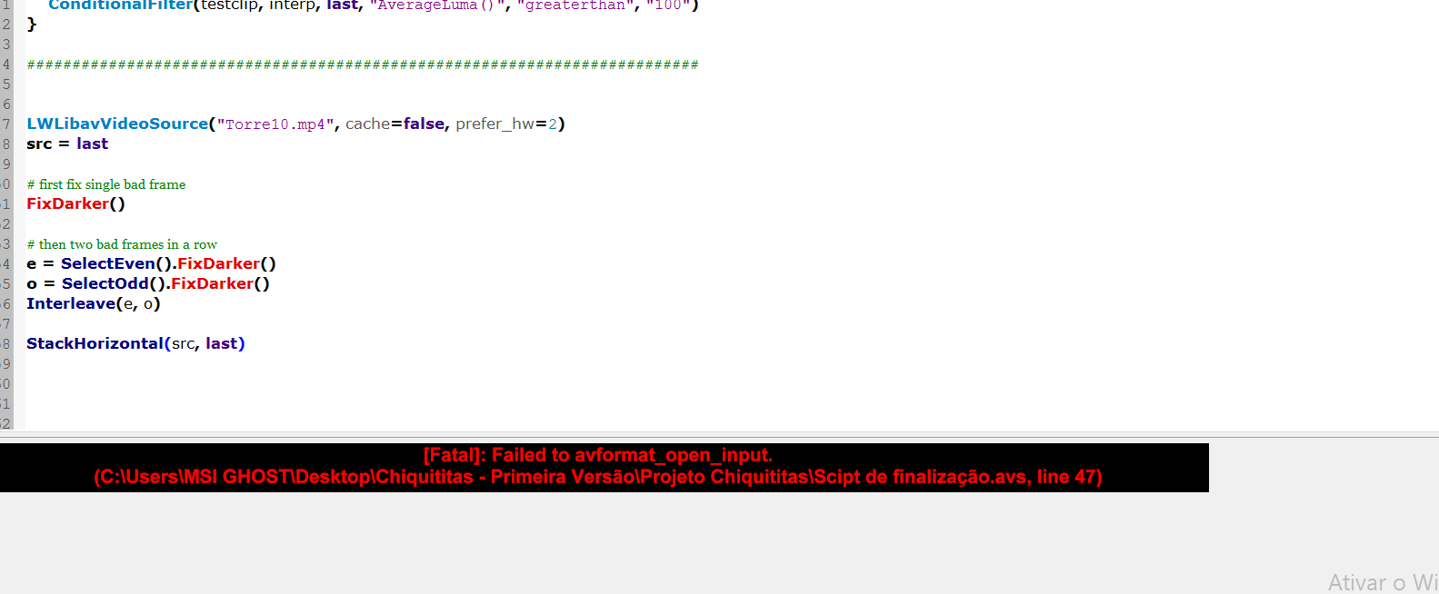

    I tried to use this function and it gave me this error, could you help me?
