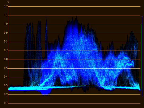

    The problem is the following... The minimum black level is at 0.25V instead of 0.3V as you can see below :
    YC Waveform (Luma in light blue):
    [Attachment 59442 - Click to enlarge]

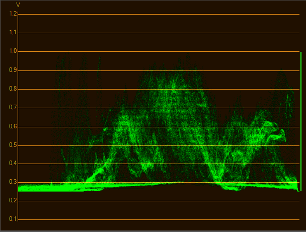

    YC Waveform (Luma only) :
    [Attachment 59444 - Click to enlarge]

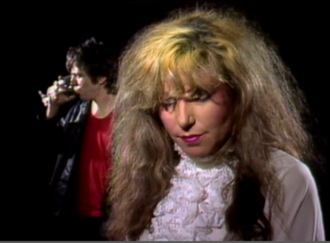

    Video :
    [Attachment 59443 - Click to enlarge]

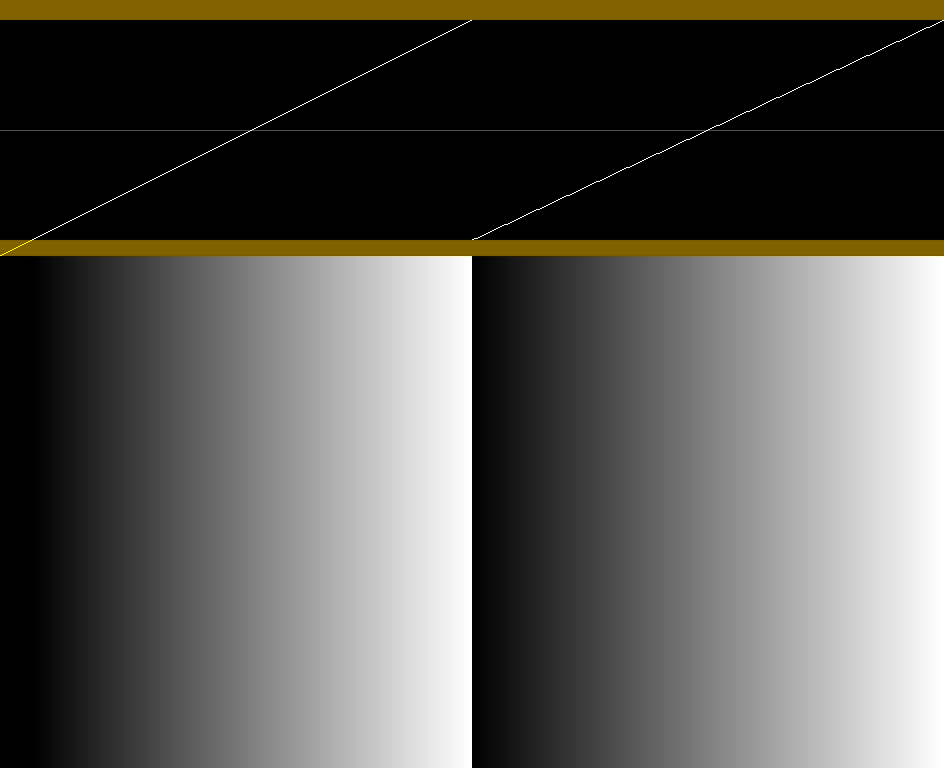

    ColorYUV(gain_y=m, off_y=n)
    To get black at 64, white at 940.
    Note that ColorYUV works in 8 bit equivalents. So off_y=1 adds 4 to all Y values when working with 10 bit video. The Histogram() function is similar.
    [Attachment 59445 - Click to enlarge]
    On the left is a greyscale ramp ranging from Y=0 to Y=940 (0 to 235 in 8 bit equivalents). On the right is the result of ColorYUV(gain_y=-17, off_y=16). You can see the superblacks are brought up to black (0 to 64), white has remained the same (940 is still 940). The details in the superblacks are now visible in the image.

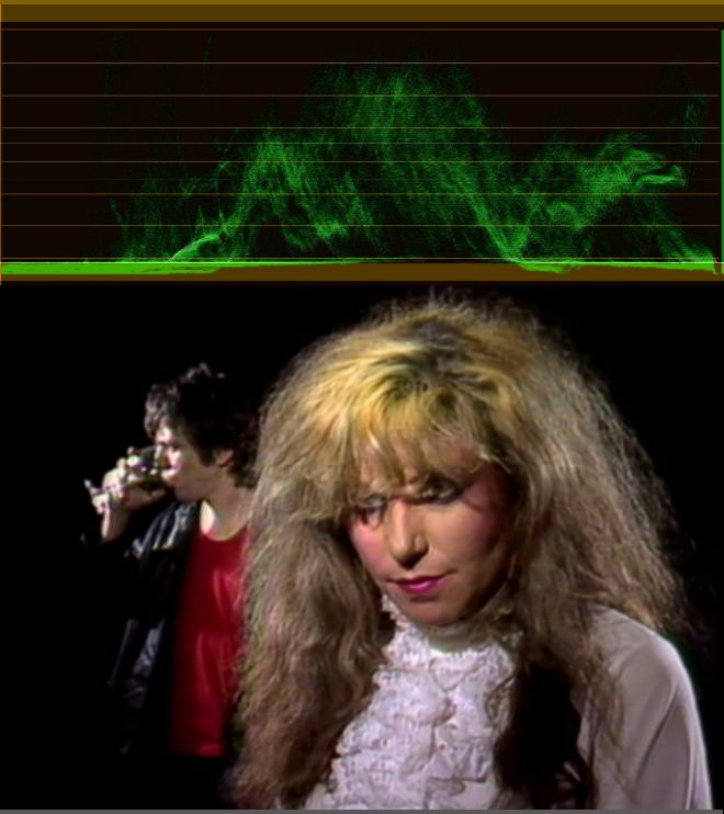

    Scaling your waveform monitor and overlaying onto AviSynth's Histogram():
    [Attachment 59446 - Click to enlarge]
    It look like you'll want something like ColorYUV(gain_y=-11, off_y=10)
