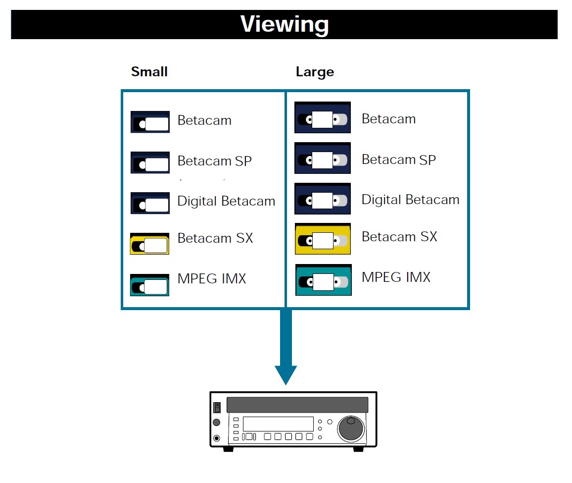

    Yes the Sony J3-SDI I have plays all standard definition Betacam formats in both sizes large and small, The reason I didn't dive into this is because the OP is asking about Betamax not Betacam, I usually wait until the OP corrects himself/herself about what exact video format he is talking about and then respond accordingly with new details.
Name:	Betacam Cassettes.jpg
