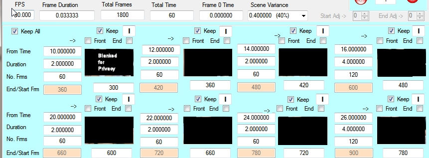

    Ok Quick test for demonstration, with 1 min 0 s video, cut between I frame 300 for 20 Seconds (Up to next I frame.)
    [Attachment 59433 - Click to enlarge]

    All streams copied and slight variation (0.007 ms) which may vary in other videos depending on length of cut, video content and compression algorithm.

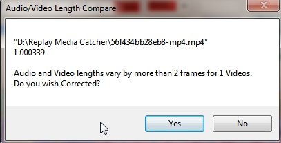

    I personally fix if it will cause a glitch between joined segments with atempo"
    [Attachment 59434 - Click to enlarge]
    ffmpeg -i "D:\56f434bb28eb8.mp4" -c:v copy -c:a aac -af atempo=1.000339 "D:\AV_56f434bb28eb8.mp4"

    All in all it plays well but since there is a gap of no audio at the end, I can only assume that when joining the audios they are contiguous and the final result is far less that 1 frame of video so I don't believe it would be noticeable.
    As I said earlier, the program I use to cut and paste checks for audio excessive loss and corrects with Atempo and makes audio the same length as the video.
    If I reencode the Video and copy the audio of the video with lees audio., the 7ms remains. Reencoding both makes them all equal of course
