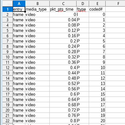

This in a batch file will get you the timestamps in a CSV file, ready to import into a spreadsheet. Or edit with a text editor.
Drag/drop a video file onto the batch file. Output will have the same base name as the video file, with a .CSV extension.Code:echo entry,media_type,pkt_pts_time,ftype,coded# > "%~n1.csv" ffprobe.exe -v 32 -stats -y -hide_banner -i %1 -select_streams v -print_format csv -of csv -show_entries "frame=media_type,coded_picture_number,pkt_pts_time,pict_type" >> "%~n1.csv"
[Attachment 59410 - Click to enlarge]Last edited by jagabo; 11th Jun 2021 at 10:54.
Thank you jagabo
It has worked nicey and has helped identify the frames where the issue occurs.
