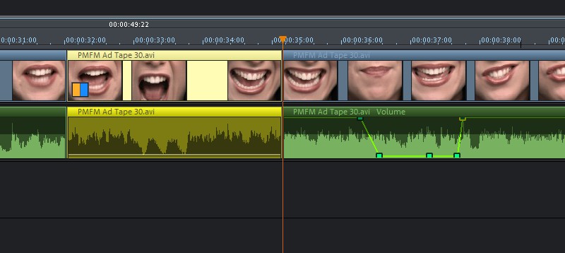

    A couple of options: 1/split your video (and therefore audio) so that the problem area becomes a separate object, then work on it; 2/Right-click on the audio and choose Volume Curve (displays as a green line). You can then control the volume at any point in the clip by clicking to create volume nodes. You'll need 4: 1st one to anchor the previous volume, the second to lower the volume in the problem area, then two more to raise the volume again to normal. You can drag the nodes in every direction to fine-tune them.
    [Attachment 59382 - Click to enlarge]
