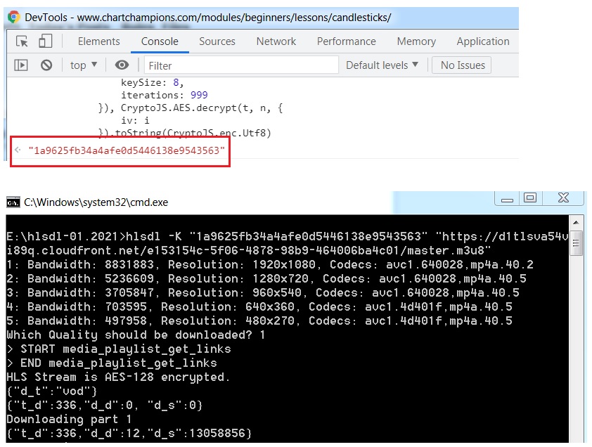

use hlsdl
hlsdl -K "1823a968725c94c2cda4827e1e5c545b" https://d1tlsva54vi89q.cloudfront.net/e153154c-5f06-4878-98b9-464006ba4c01/master_Ott_..._8500Kbps.m3u8 -
sorry, i made a mistake the corect cammand is:
hlsdl -K "1a9625fb34a4afe0d5446138e9543563" https://d1tlsva54vi89q.cloudfront.net/e153154c-5f06-4878-98b9-464006ba4c01/master_Ott_..._8500Kbps.m3u8 -

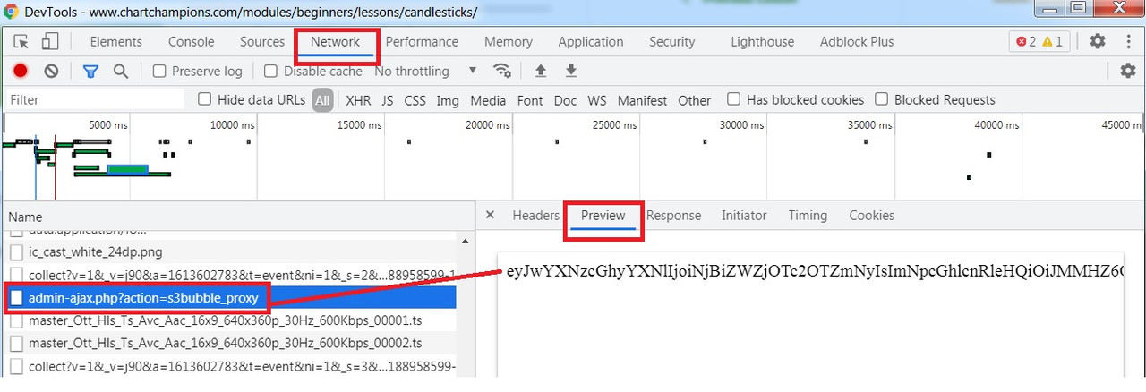

You need find "keys response" for this video
and view this key in F12 --> console tabCode:eyJwYXNzcGhyYXNlIjoiNjBiZWNhNWYzNzY2MiIsImNpcGhlcnRleHQiOiJsWklaelFuT04xZlN4T3ByVW9uNFlrTnNKS2RudkVZSjVpOXAwUytUQmxsMlNjWlhod3BWNld2SkZqMTVqOFhpIiwiaXYiOiIzMjgxYTFiNjFkOWE5NWMyZmNlZTJhYmQxZGRkMDk1NyIsInNhbHQiOiIwZDQ3YmEyZWQ1ZWNkNDYwZTJhNGNmYmU2MGY1NjBlMSJ9
Whenever I open https://chartchampions.com/wp-admin/admin-ajax.php?action=s3bubble_proxy
I get different base64.
Thus I get different key.
Thus I cannot decrypt. -
Don't open the link directly. Go to any video, F12, look for the ajax.php, get the response string and decrypt that on the console, it works only for that video.
