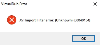

I copied the text and saved in .avs file this VirtualDub error
[Attachment 59427 - Click to enlarge]

You have to install the LSMASH source plugin to use LWlibavVideoSource(). Since you have DSS2() working you can just use that.
