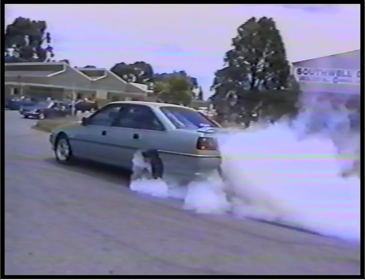

  1. What are these horizontal flickering rainbow like bar/streaks?
    Is there anyway to remove them?
    [Attachment 59205 - Click to enlarge]
  2. I'm sure there is a terminology used to describe it, I just do not know what it is, so cannot even search for a possible answer.
    That's not me driving btw
    Chroma noise
    best = recapture with S-VHS VCR with line TBC + DNR
    decent (usually) = CCD filter in VirtualDub

    Already captured with S-VHS TBC + DNR.
    I am unable to use VirtualDub for capturing as it does not support the Avermedia CE310B capture card, and Avermedia's own capture software has no options.
    What I am asking for is which Avisynth filter is used to deal with this? Maybe nothing can, but I am just asking.
  5. Originally Posted by agisthos View Post
    You could try CnR(), DeRainbow() for example. See "Rainbow & Dot Crawl removing" section in the avisynth wiki.
    http://avisynth.nl/index.php/External_filters#Rainbow_.26_Dot_Crawl_Removal
    When you upload a short video sample you may get better advice.

  8. How about this?
  9. Originally Posted by Sharc View Post
    How about this?
    That very good, over 90% removal. How did you do it?
  10. Originally Posted by agisthos View Post
    A bit of butchering. There were not too many details in the source though.
    AVISource("burnout.avi")
    converttoYV12(interlaced=true)
    assumeTFF()
    separatefields()
    AddGrainC(3)
    e=selecteven().Derainbow(1).Derainbow(1).MCDegrainSharp()
    o=selectodd().Derainbow(1).Derainbow(1).MCDegrainSharp()
    interleave(e,o).assumefieldbased().weave()
    QTGMC()
