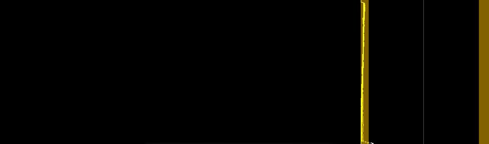

  7. Originally Posted by Santuzzu View Post
    Thanks a lot jagabo for this elegant solution. Are these luma offsets (-121 and 5) manually adjusted?
    Yes. If you examine a Histogram() of the mask just after Subtract() you'll see most of the values around 128:
    [Attachment 59230 - Click to enlarge]

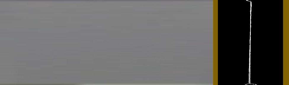

    If you added that with Overlay() many pixels would be way over 255. If you subtracted many pixels would be less than 0. So I pulled the brightness down to bring the darkest pixels to zero (ignoring the crap at the top and bottom of the frame):
    [Attachment 59231 - Click to enlarge]
    After subtracting that from the even fields the whole fields was a little darker than the odd fields. So I added 5 units back to Y.
