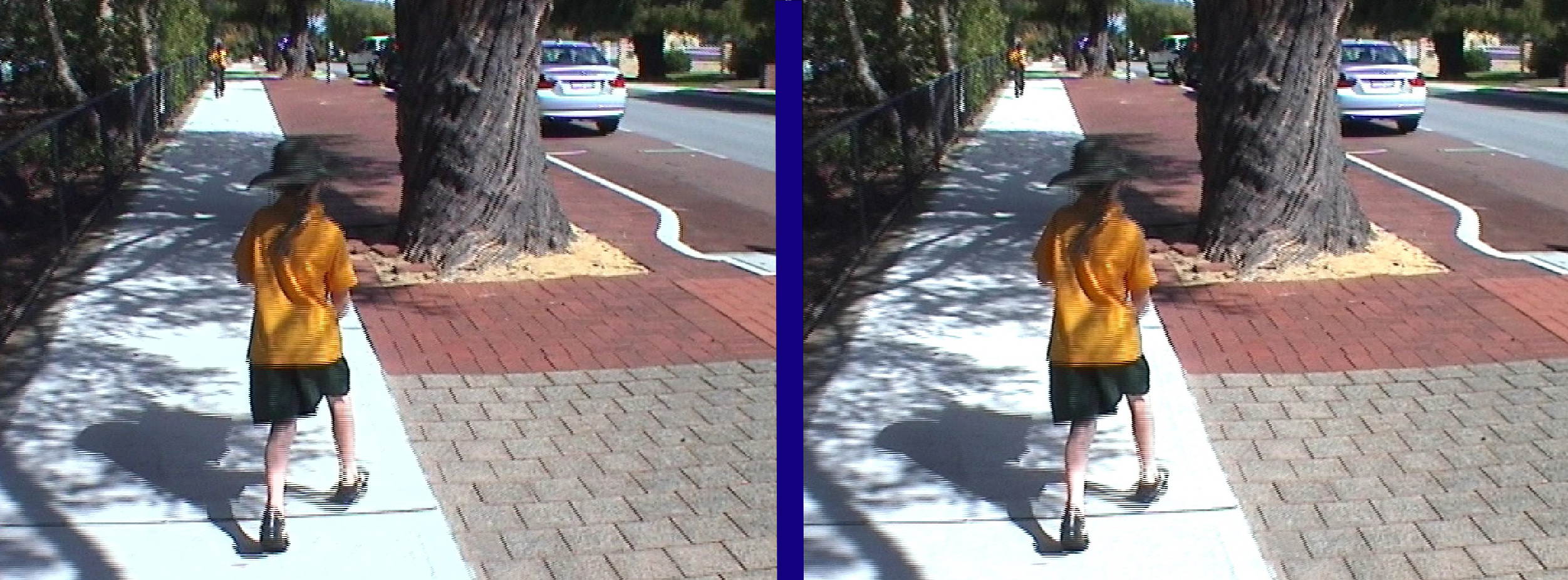

    An interesting comparison between an S-Video capture of an SD DV tape played in a Sony TRV-110e through my IOData GV-USB2 and a DV transfer via Firewire of the same tape:
    [Attachment 59191 - Click to enlarge]
    Unfortunately, the HV20 doesn't have S-Video Out.
