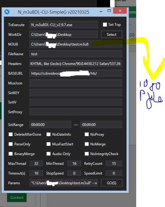

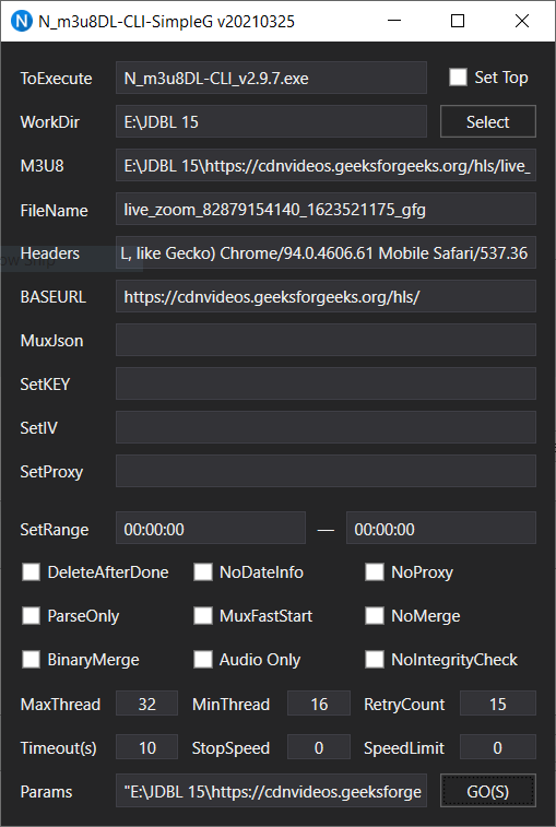

    Attaching the configuration I have used.
    [Attachment 59313 - Click to enlarge]
    [Attachment 59293 - Click to enlarge]
    Solved.
