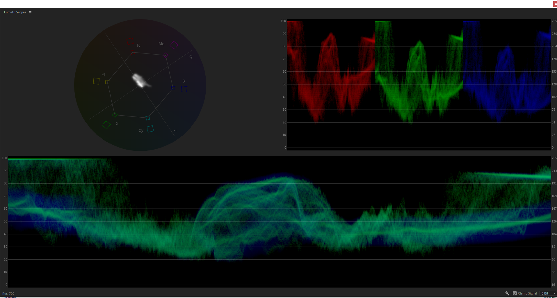

    Here are some samples for your appreaciation:
    original MPEG-4 AVC/H.264 24 Mbps LPCM VBR (4:2:0)
    [Attachment 59129 - Click to enlarge]

    Curves and scopes

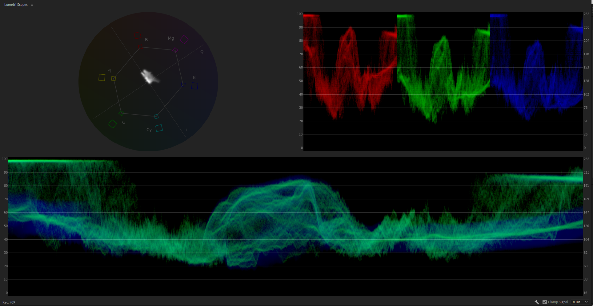

    Curves and scopes
    [Attachment 59132 - Click to enlarge]

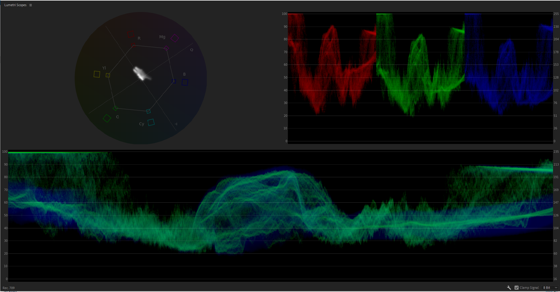

    Curves and scopes
    [Attachment 59134 - Click to enlarge]

  2. The 4.2.0 8bit color codec that, when I try to color grade, starts to fall apart.
    Did you mean in terms of artifacts ? What is "falling apart" ?
    You're denoising it by using prores, but losing some signal detail as a trade off. Depending on which model you used in Topaz, that might apply some denoising as well. People convert to Prores because it's easier to edit. If the noise is limiting your ability to grade, then denoising might be beneficial for your specific workflow. The quality is techically worse.
    On the other hand, if you use a dedicated denoiser workflow and lossless intermediates - you might be able to target the noise better and retain more details
    You provided lossy jpg's which add additional artifacts, but if you look closely you can tell the ninja retains the most details, and the most noise (esp. chroma noise) . The range is undetermined, because you provided a jpg, not the native ninja stream. There is clipping in the hair, but that is likely from the jpg conversion. Also , in the lumetri view you have clamp signal, so you cannot tell if there are additional details in the actual stream
    The color is shifted (709/601 mismatch) on the upscale - you probably just used the mts directly in Topaz, and the RGB conversion was done incorrectly. Topaz works internally in RGB, and that is potentially a problem for clipping. It does not matter that you export in prores, the clipping occurs at the RGB conversion stage before prores. To get ideal results in Topaz (or anything for that matter) you generally need to pre and post process correctly. Not only is color shifted, but the highlights are clipped in the RGB conversion - hair detail is lost and not recoverable. The correct way to do this is either legalize the range first, or use a full range conversion to RGB if using Topaz.
    It's generally a mistake to clip usable data so early, and that definitely limits your grading in other ways than noise - your dynamic range is limited. Colorists generally like to have all the data so they can manipulate it in the way they see fit, instead of discarding some right off the bat
    This is an apng, it should animate in most browsers, but you can see the hair detail clipping

  4. Originally Posted by poisondeathray View Post
    By falling apart I mean that when I start to grade on Premiere Pro, applying LUTs, etc, I notice the introduction of blocking and loss of detail.
    It seems that the detail and quality of the original MTS starts to look compressed and with less resolution.

  5. Originally Posted by dogmydog View Post
    Sorry for my newbie question, but what do you mean by this?
    What would be a dedicated denoiser workflow? I do not use proxy and always work with the original MTS files straight into premiere pro for grading and editing.
    I mean use dedicated denoiser such as neat video, or preprocess in avisynth etc... They will probably do a better job than relying on a codec such as prores to denoise and deblock, because that' s their specific job. But some of the models in Topaz might do a good job too with denoising, it depends on what model was used and how the model was trained. It can be a delicate balance between over denoising and losing fine details
    The ninja is the closest to the "original" signal, and it keeps the highlights. The tradeoff for retaining more details, is retaining more of the sensor noise.
