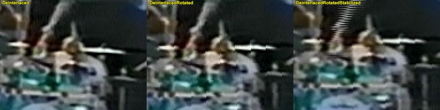

    I see what's going on. The stabilized video was created from the rotated video (which in turn was made from the QTGMC'd video) and re-interlaced from 60p to 30i, creating new comb artifacts. Here's a crop/zoom from the three videos, side by side, when there's not much shaking:
    [Attachment 59174 - Click to enlarge]
    The stabilized video has retained most of the aliasing created by the rotation.
