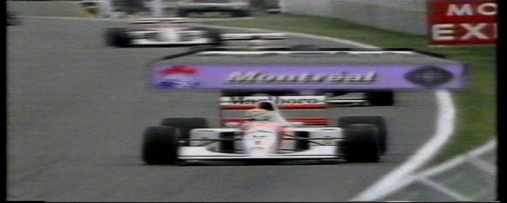

    There's horizontal pixellation, as if this was resized up from a lower resolution by Nearest Neighbor (like PointResize in Avisynth).
    First is a field, second is the same field but halved and then re-doubled using a better resizer, specifically BicubicResize(width/2,height).BicubicResize(width,height).
    [Attachment 59151 - Click to enlarge]
    [Attachment 59152 - Click to enlarge]

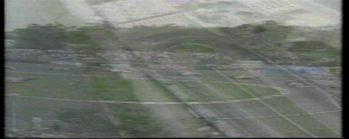

    There is field-blending, but I assume this was part of the original broadcast, as a result of some standards conversion.
    [Attachment 59153 - Click to enlarge]
