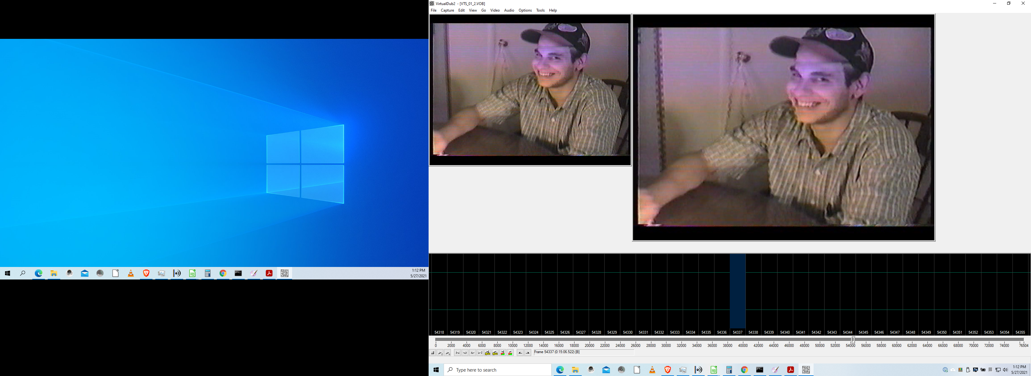

As for samples. I discovered something.
The problem occurs when VLC is configured to either AUTO or deinterlace.
Looking at the VOB, it appears DVD Styler chose bottom field first.
The source, marked as progressive is interlaced top field first.
So I changed the SVD Styler setting to Top field first.
My reasoning is that if DVD Styler interlaced a top field first source as bottom field first it would probably screw it up horribly and VLC wouldn't know what to do.
So by changing it to top field first, maybe VLC will deinterlace it and he waves will go away.
Just for kicks, I opened the vob and applied a bottom field first filter and it recreated the waves I saw in VLC.
This is screen shot just to show what I mean by wavy. Look at the door jam in the left picture.
[Attachment 59143 - Click to enlarge]Last edited by jpvoodoo; 27th May 2021 at 12:44.
