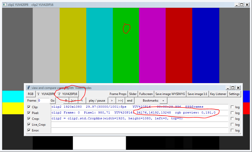

  8. yes, as was said, changing bitdepth should do nothing, IF there was no processing in between or something, look at some green YUV values for example and their rgb preview values, they are the same except rounding errors, YUV420P8 is changed to YUV420P16:
Name:	YUV420P8 to YUV420P16.PNG
