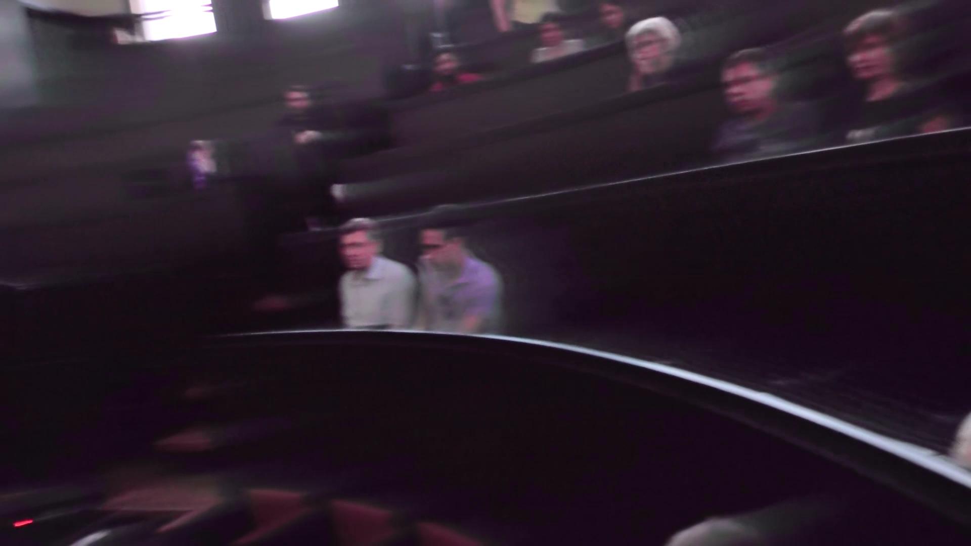

    Need to remove a green value of RGB / pure greens, a chroma part of green. So green may become grey. That is a form of experimentation, since I can't escape green smear: https://forum.videohelp.com/attachments/59044-1621573096/Untitled3.mp4
    Most of those "greens" are already near grey. They just look green because the rest of the image is overly purple. Here most of the greenish smear is crudely replaced with pure grey:
    [Attachment 59068 - Click to enlarge]
    Most of the smear still looks green but if you load the image into an image editor and use an RGB tool you'll see they're pure grey.
    To get them looking less green you have to replace them with slightly purple shades:
    [Attachment 59069 - Click to enlarge]
  7. Thanks for showing me this and spending time on this. May I ask, what software did you use with what settings?
  8. I used AviSynth for the processing: For the former:
    LWLibavVideoSource("Untitled3.mp4", cache=false, prefer_hw=2)
    gmask = last.ColorYUV(off_u=-2, off_v=-2).MaskHS(startHue=180, endHue=270, minSat=0, maxSat=15).BinomialBlur(3.0).BilinearResize(width, height).ConvertToYV12()
    Overlay(last, GreyScale(), mask=gmask)
    For the latter:
    lessgreen = ColorYUV(off_u=5, off_v=5)
    Overlay(last, lessgreen, mask=gmask)
    I may have changed the values a little since posting but those should be very close. Basically MaskHS() was used to build a mask of all the greenish areas. Then a grey or less green version of the video was overlaid using that mask as an alpha channel.
