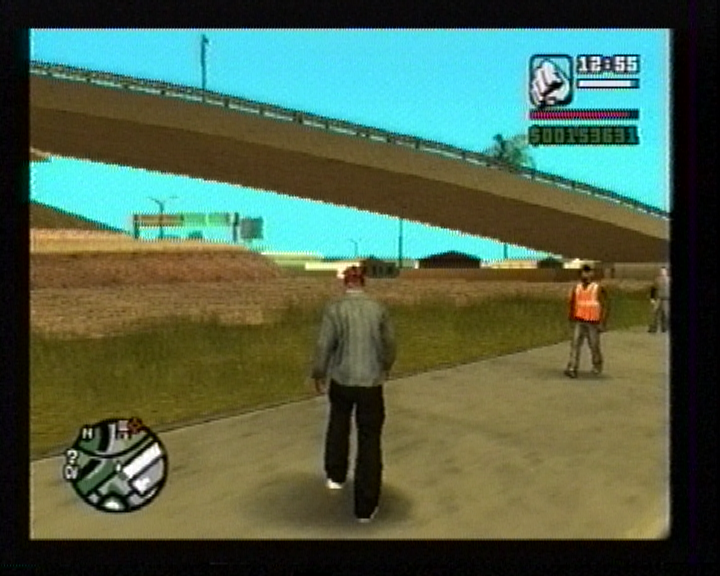

  1. That I've never seen before and weren't present on any other device I've used. What are they? and how do I get rid of them?
    Device is a Happauge USB live 2, I'm recording in AmarecTV, but the patterns are there whatever I preview in. Source is PAL VHS.
    Sample attached.
    Mar 2008
    Looks like herringbone noise. Try a different cable, S-video cable Vs. composite, different VCR
  3. Originally Posted by davexnet View Post
    Thanks, what's herringbone noise? Just so I have a clearer idea of what's happening.
    It doesn't appear with other devices, same cables, same VCR, so why would it manifest itself with this particular device?
    If this helps further diagnose the issue, I've found that tapping on the AV scart connector, where the comp hooks up to the VCR, seems to make it go away for a split second. Included a sample to illustrate this, from about 3 seconds in I managed to make it go a couple of times.
    The only other VCRs I have are faulty, except one, but it's identical to the one I'm using.
  4. In this case it's the Chroma carrier of a composite signal leaking through to the luma. After some heavy filtering in AviSynth...
  5. Originally Posted by jagabo View Post
    Wow, you did a good job cleaning that up.
    So why did that not happen with the device I was using before, is my device faulty?

  7. Originally Posted by Soundguy View Post
    Your former device had probably a better comb filter (3D comb filter) for separating the chroma from the luma.

  9. The video chips in these capture cards are very bad at handling the unstable video signal coming from a VCR, which leads to the horizontal wiggling you see and the card not separating chroma/luma (color/brightness) very well on this kind of input. That said there are things that can make it worse like bad cables, issues with the vcr and so on. Common budget solution here is to put a dvd-recorder, often a panasonic, in between the vcr and the capture card which in practice means using the way better video decoder in the dvd-recorder to deal with the unstable video.
    I can't find my comparison with a panasonic right now, but here's an example comparing a raw capture of a dodgy tape with one that's been passed through a Pioneer DVD-440H. The difference is pretty stark (the panasonics will generally be a tad better still.)
  10. I agree with oln, a line tbc is needed. I think the OP's previous caps were so blurry all the noise was blurred away. For what it's worth here's the script I used:

  21. I've got the new VCR. It's in very good condition and works thankfully. A noticeable improvement in quality but there are still comb like artefacts, they are very apparent on edges, like the edge of the overpass in the sample. The VCR came with no cables so I'm just using the composite cable I already had.
    Would switching to S-Video eliminate these artefacts?
    FYI, the VCR is a PANASONIC NV-HS950
  22. S-video will get rid of the dot crawl. It won't help with the aliasing.

  27. It's best if you can avoid the dot crawl by capturing s-video. But you can reduce it with software without too much damage:
    before:
    [Attachment 59113 - Click to enlarge]
    after:
    [Attachment 59114 - Click to enlarge]
