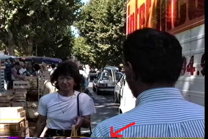

    In all the Video8 tapes played back for capture (amarec, lagarith) there is this banding at the bottom of the frame (capture below). I don't know what it's called so can't research it.
    It looks like there is visual information there which is somehow distorted. Is it possible to "correct" it and get that information, rather than just crop it out?
    During playback in camcorder, LCD viewscreen does not show such banding.
    Cheers.
    [Attachment 59051 - Click to enlarge]

    It is "head switcihng noise".
    http://www.avartifactatlas.com/artifacts/head_switching_noise.html#:~:text=Head%20swit...%20derivatives
    You don't have to crop it, but to mask it. For example with AviSynth
    (crop(0,0,0,-X).addborders(0,0,0,X)
  3. Head switching noise. Different players may have more or less of it. A line time base corrector can clean up a lot of it.

  5. Google for 'Head Switching Noise'
    When you crop it off and also crop the right black bar off you will preserve the aspect ratio, and you can play it back at the intended DAR without distortion.
    Edit: or as lollo suggested replace it with a black border and keep the 720x480 standard size. Easy with Hybrid.

    You can also have a look at a procedure that jagabo (who also replied) developed:
    https://forum.videohelp.com/threads/397742-This-is-working-for-me-PAL-VHS-capture-unco...e2#post2587587

    Why is masking preferable to cropping?
  9. Captures & Restoration lollo's Avatar
    Jul 2018
    Italy
    Because you keep the original captured height, that should be "good" (480 or 576), and the "standard" proportions.
  10. Some codecs and devices require specific frame sizes. For example, NTSC DVD requires a 720x480 or 704x480 frame. Mpeg2 encoding requires mod 16 frame sizes. Cropping is fine if you don't have such restrictions on your intended playback device or codec.

    I will use cropping since the purpose is to capture video8 tapes, convert them, and then share with friends via google drive or dropbox, which do not appear to require a standard frame size.
    Cheers.
  12. Originally Posted by Rahneshin View Post
    Correct. You only need to assure the frame size is valid for your encoder. You will need at least mod 2 for progressive YV12 video, mod 4 for interlaced YV12, I recommend mod 4 because some old players will not work properly with mod 2.

    By encoder, do you mean the device which converts the analog signal from the camcorder (usb-live2), or the capture software (amarec, vdub)?
    I've seen the term "mod" in Hybrid in Crop/Resize->Base but have not touched it as I am resizing PAR instead to correct a slight 'vertical compression' (people look a little boxy) in my video captures. (This also allows the native resolution of NTSC 720x480 to be preserved while still 'resizing' the image, right?)
    Pretty sure my video captures are interlaced as the artifact(?) is very present in them.
    So, for me, given the above, (and assuming I leave PAR alone) you would recommend, in Hybrid: Crop/Resize->Base, Resize Picture, Resize Method: 10-bicubic spline, Auto adjust: height, to mod: 4. Correct?
    Please forgive all the questions, but each answer you experts give just throws up a whole bunch of new questions! Thanks for your time.
  14. By "encoder" I meant the codec you use to compress your video. x264, x265, etc.
    If your source is interlaced you should deinterlace (QTGMC is best) before resizing and cropping. Or you can leave it interlaced and encode it interlaced -- interlaced video should be cropped on mod4 boundaries.
    Mod N means integer multiples of N. So mod 4 is 4, 8, 12, 16... 468, 472, 476... 704, 708, 712, 716...
