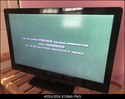

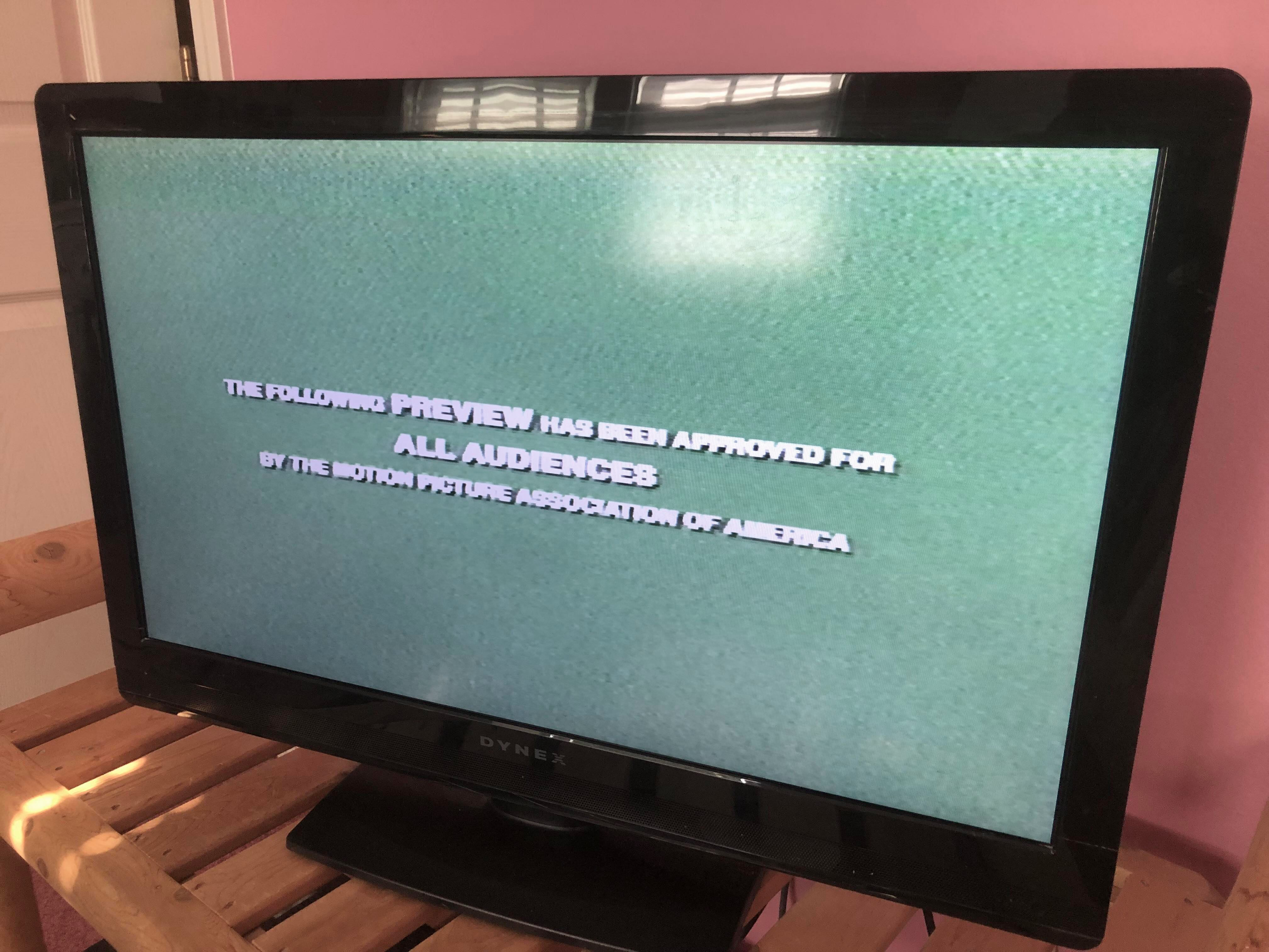

    I decided I'd pop one of my old VHS Hollywood movies into play from the year 2002. It had major issues right away.

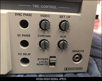

    I wanted to test out the TBC controls. When I adjust the controls nothing happens and I tried ''local', and 'remote' just for kicks. I also witnessed the color is a little washed out and noisy. I hooked up to S-VIDEO out. The image you see should be deep green on other VCR's. Please excuse the fact that I don't have a capture device hooked up. I've seen these decks work much better than this.

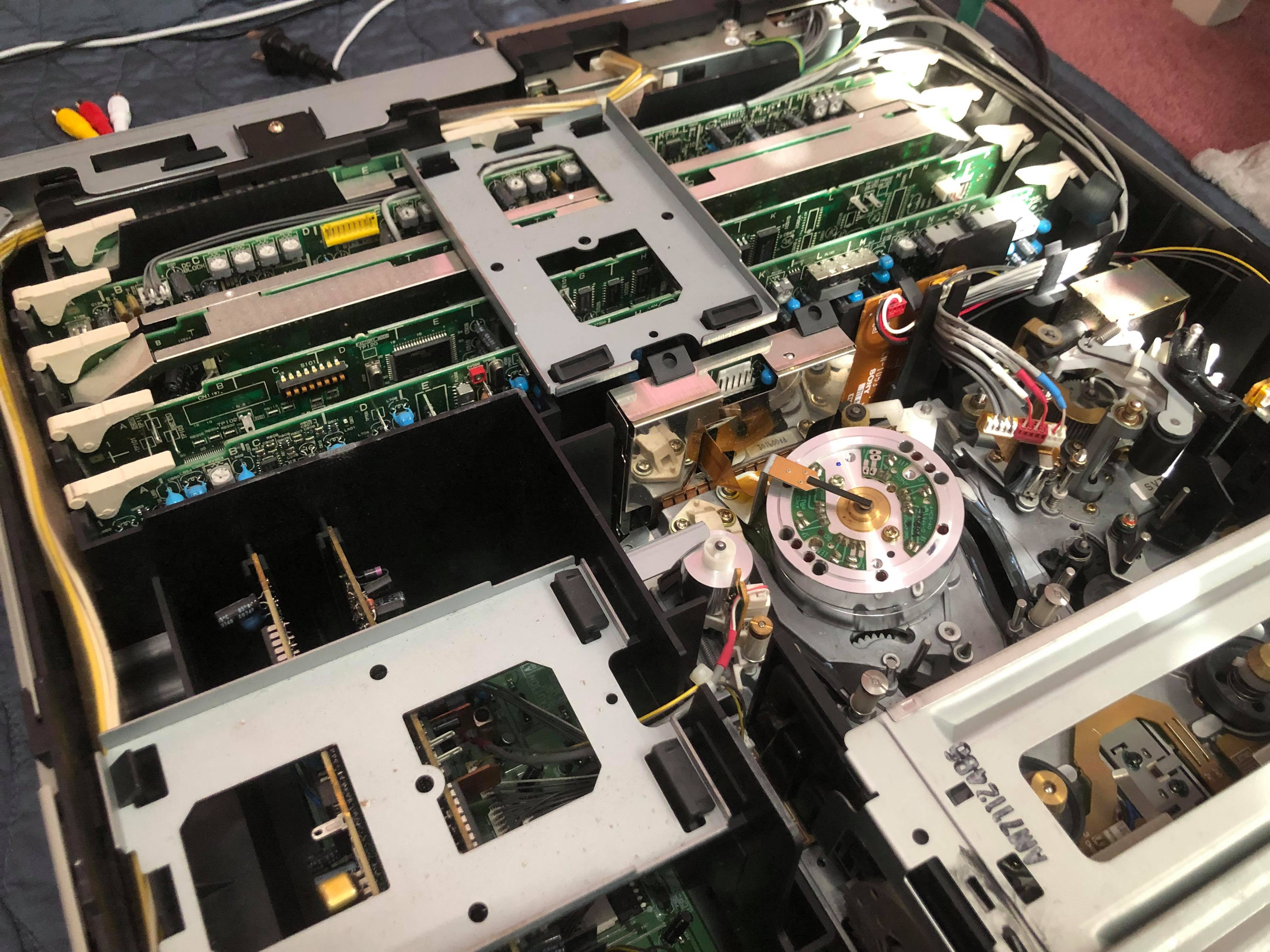

    I then thought to myself, maybe the TBC cards were taken out. I opened up the cover and it doesn't appear to be any cards missing but could be wrong. The heads are incredibly clean, and I don't see any burned or oozing capacitors on the boards. Is there any other reason TBC controls would not be responsive? Also if this would make a difference, I am running the S-Video feed into an HDMI upscaler. Don't see why that would disable the controls though.

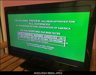

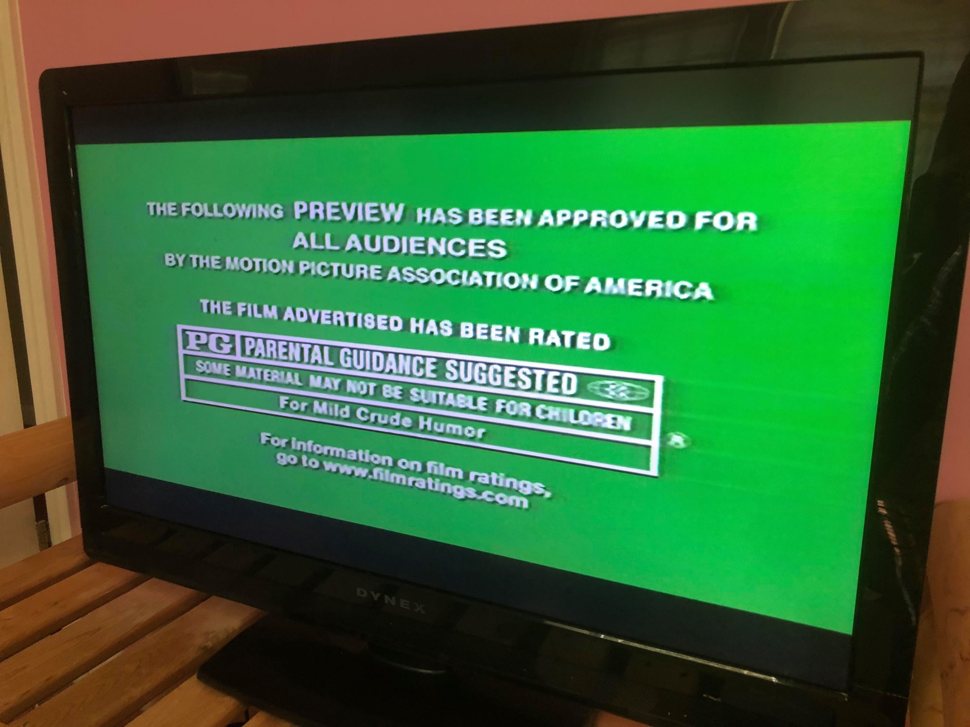

    Wow, that is a huge difference and what a relief! Different trailer that had bars but same color.
    So I kept flicking the TBC bypass switch on and off 20+ times. All of a sudden the TBC switch now works.
    Those white streaks are artifacts from the cheapo upscaler.
