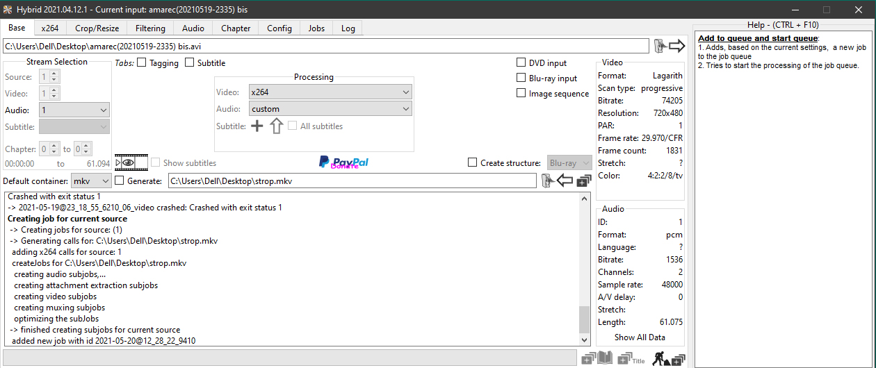

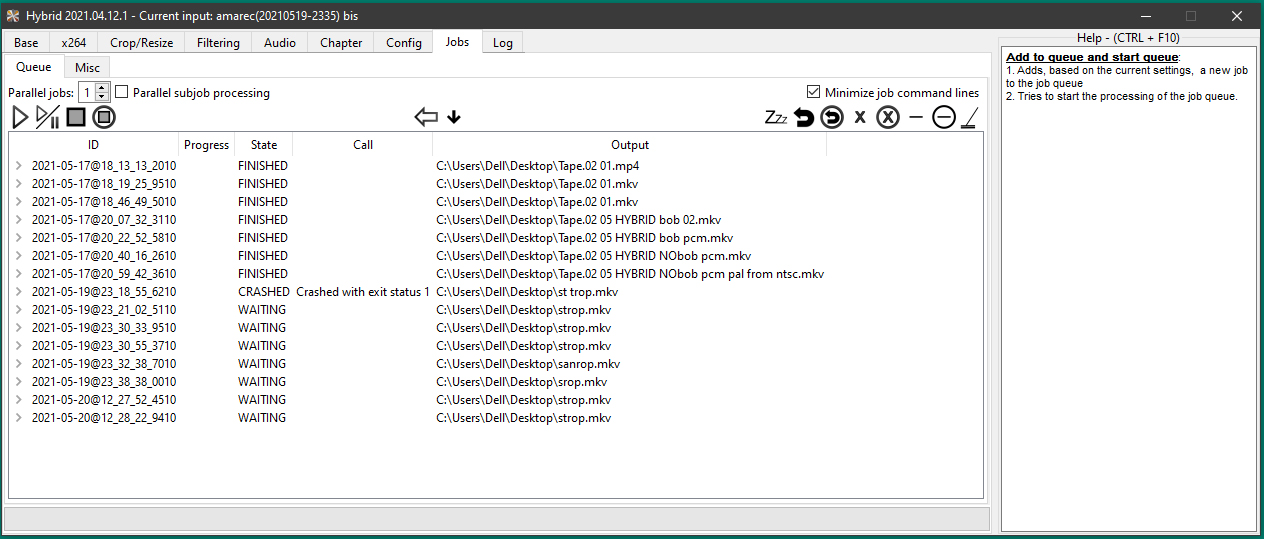

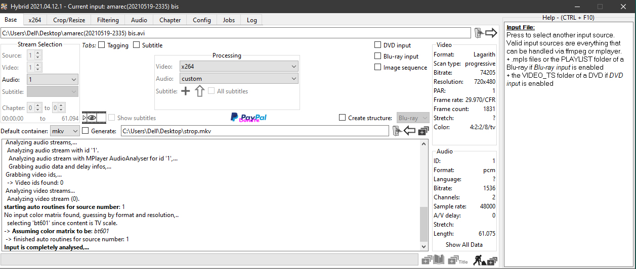

    Up until a few days ago was able to edit avi files in Hybrid. Now the files either crash (with "exit status 1") or they are "waiting".

  2. Those screenshots don't explain anything, read https://www.selur.de/support share a debug output and describe properly what you are doing.

    Looking at the job queue that got created
    1st pass is present:
    (2021-05-20@17_21_04_7510_05): ffmpeg_32 -y -loglevel fatal -noautorotate -nostdin -threads 4 -i "C:\Users\Dell\AppData\Local\Temp\encodingTempSynthSkript_2021-05-20@17_21_04_7510.avs" -an -sn -pix_fmt yuv420p -vsync 0 -f rawvideo - | x264 --preset veryfast --pass 1 --bitrate 7000 --profile high --level 4.1 --direct auto --b-adapt 0 --sync-lookahead 6 --qcomp 0.50 --rc-lookahead 40 --qpmax 51 --aq-mode 0 --sar 10:11 --non-deterministic --range tv --stats "C:\Users\Dell\AppData\Local\Temp\strop_2021-05-20@17_21_04_7510_05.stats" --demuxer raw --input-res 720x436 --input-csp i420 --input-range tv --input-depth 8 --fps 60000/1001 --output-depth 8 --output NUL -
    2nd pass is present:
    (2021-05-20@17_21_04_7510_06): ffmpeg_32 -y -loglevel fatal -noautorotate -nostdin -threads 4 -i "C:\Users\Dell\AppData\Local\Temp\encodingTempSynthSkript_2021-05-20@17_21_04_7510.avs" -an -sn -pix_fmt yuv420p -vsync 0 -f rawvideo - | x264 --preset veryfast --pass 2 --bitrate 7000 --profile high --level 4.1 --ref 3 --direct auto --b-adapt 0 --sync-lookahead 6 --qcomp 0.50 --rc-lookahead 40 --qpmax 51 --partitions i4x4,p8x8,b8x8 --no-fast-pskip --subme 5 --aq-mode 0 --vbv-maxrate 62500 --vbv-bufsize 78125 --sar 10:11 --non-deterministic --range tv --colormatrix bt470bg --stats "C:\Users\Dell\AppData\Local\Temp\strop_2021-05-20@17_21_04_7510_05.stats" --demuxer raw --input-res 720x436 --input-csp i420 --input-range tv --input-depth 8 --fps 60000/1001 --output-depth 8 --output "C:\Users\Dell\AppData\Local\Temp\2021-05-20@17_21_04_7510_06.264" -
    Seems like the temp files exist when the job processing is started and then Hybrid starts the 2nd pass before the first pass since it assumes that's what should happen.
    => clearing your "C:\Users\Dell\AppData\Local\Temp\" folder probably fixes the issue.
    Cu Selur

  6. Ehmm,... clear you job queue.
    The job creation in the job processing is for job 2021-05-20@18_51_15_2910_X
    But you start processing some old job 2021-05-19@23_18_55_6210_X which seemingly was stopped or crashed at some point.
    -> you should at leas reset the 2021-05-19@23_18_55_6210_X job so that the debug output contains the whole processing.
    May 2021
    France
    Indeed. I aborted all jobs after 2021-05-19@23_18_55_6210_X and then reset it. Hybrid did that job and everything came out perfect.
