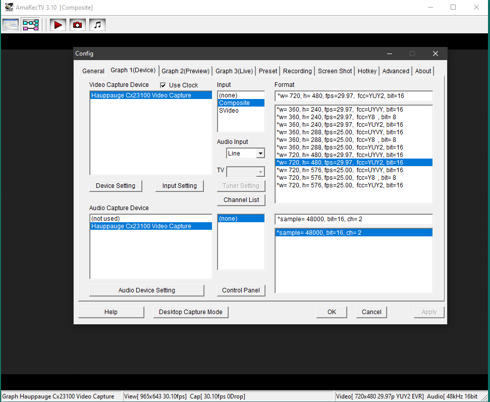

Hello all,
Until yesterday, Amarec recognised my USB-Live2 device by name in both 'Video Capture Device' and 'Audio Capture Device.'
Now it only sees "Hauppage Cx 23100 Video Capture" in both device fields. No mention of audio capture device in the audio field. (capture below)
Video and audio record fine nonetheless. However, values set in Device Setting->Video Proc Amp are not applied when recording. No control over contrast and brightness = 'blown' highlights and whites.
Any help or advice much appreciated.
[Attachment 59017 - Click to enlarge]

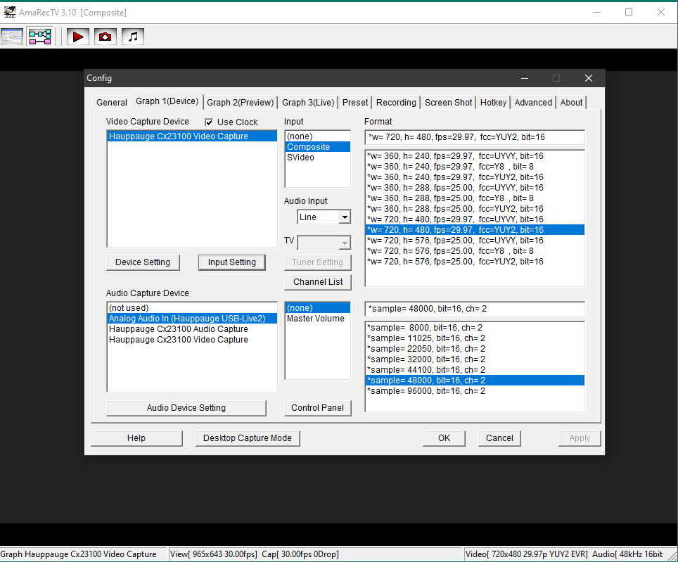

	Hi DB83,
 I ran hcwclear.exe, uninstalled Hauppage Capture, and reinstalled WinTV.
 Usb-live is mentioned by name now in the audio device field (capture below). I'm sure it was the same with the video field before. In any case, it records fine either way. Just couldn't understand why it suddenly disappeared and if it was the reason procamp settings were being ignored during recording.
 For procamp, it seems there is another program called graphstudionext which sharc in the first thread linked by lollo above recommends for 'locking in' procamp settings during recordings in amarec.
 Cheers.
 [Attachment 59021 - Click to enlarge]

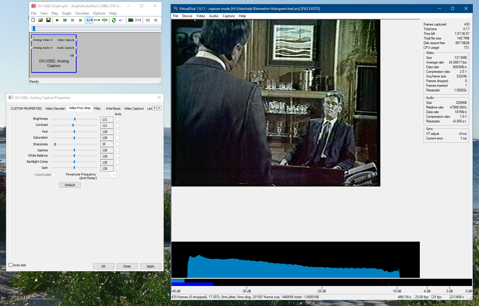

	Rahneshin, have you tried Virtual Dub for capture (you may have said so somewhere but I don't recall)? It has a basic Histogram that allows adjustments of the brightness and contrast (and other parameters) prior to or during capture. Brightness controls the left end and Contrast controls the right end. The best VDub for capture according to Lord Smurf is VDub 1.9.11.
 This is with my IO-Data GV-USB2 using Graphstudio for access to the Proc Amp.
 [Attachment 59081 - Click to enlarge]Last edited by Alwyn; 22nd May 2021 at 22:53.

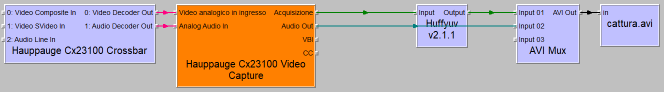

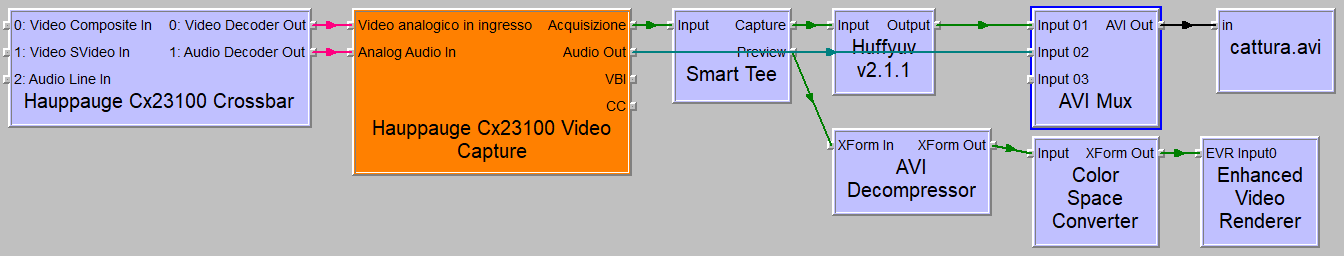

 Here 2 graphs I use sometimes with my Hauppauge USB-Live 2:
 capture without video and without audio preview
 [Attachment 59088 - Click to enlarge]
 capture without audio preview (the video rendering part highly depends on the system)
 [Attachment 59089 - Click to enlarge]
