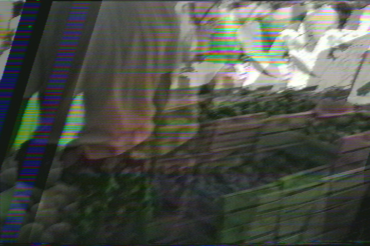

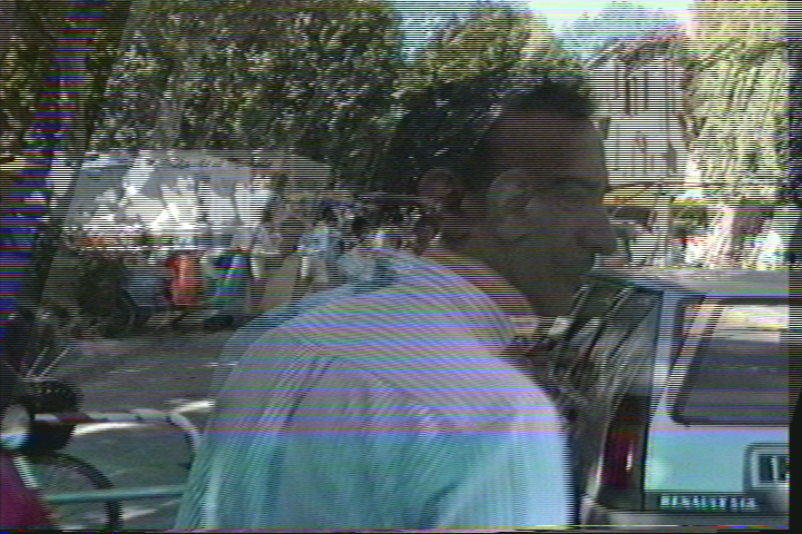

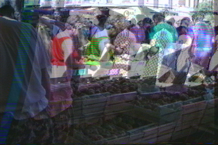

    Have been transferring analog Video8 tapes and keep running into this issue (snaps below). Flickering and jumping of the image. Sometimes it gets pretty bad.
    My set up: Video8 tape -> Sony Camcorder -> USB-Live2 -> Amarec (Lagarith, null frames NOT enabled)
    Playback issue in the camcorder? Problem with the decoder? Problem with the tapes?
    My gut says camcorder issue, but people keep mentioning "dropped frames" in relation to their decoder cards. Is this that?
    Any answers would be helpful, especially how to eliminate this problem.
    [Attachment 58986 - Click to enlarge]
    [Attachment 58987 - Click to enlarge]
    [Attachment 58988 - Click to enlarge]

    Upload a short 10 secs sample. Use avidemux in copy mode (avi muxer format)
  3. Member DB83's Avatar
    Jul 2007
    These are time-base errors. Read the forum re TBC's and pass-though with dvd-recorders.
    May 2021
    France
    Thanks, DB83.
    By finding out what TBC is, I realised it was not turned on in the camcorder! Problem seems to have gone away now that it is set to ON.

    The artifact shown above is called flagging, it's line timing errors, The line TBC should get rid of it, also you want DNR ON to clean up the chroma signal.

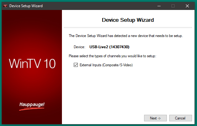

    Both in the capture software for the usb-live2 and in Amarec the settings are for s-video.
    DB83 alerted me to TBC and I've now set it to ON in the camcorder. DNR is set to ON as well.

    [Attachment 59016 - Click to enlarge]
