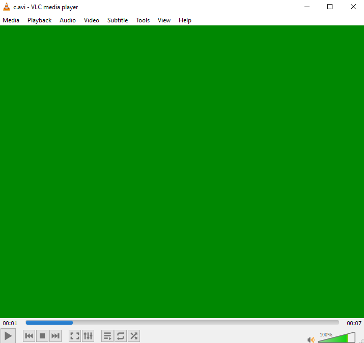

    Mine's solid green throughout. Audio works though.
    [Attachment 58983 - Click to enlarge]

    Just to be certain we are on 'the same page' (if this is not) do a short 10 sec capture sample using Lagarith and upload that to this topic as an attachment.
    If you already have a Lagarith capture with this defect then use avidemux to snip 10 secs of it using the A/B markers. Select 'copy' for video and audio and save with output set to 'avi muxer'
    Beyond that you will have to declare the settings on each vdub page - screen caps of the pages will be more useful. The aim is to replicate the issue and thus determine the solution.

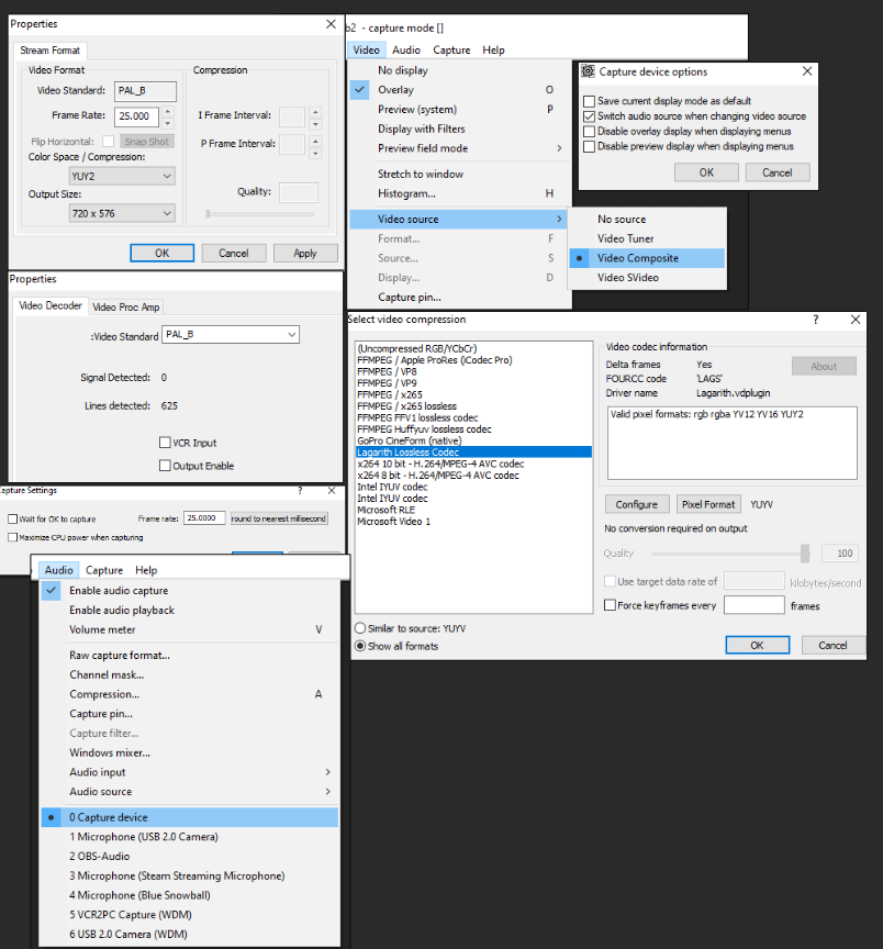

    Apologies is this enough information?
    [Attachment 58994 - Click to enlarge]
  8. Member DB83's Avatar
    Jul 2007
    A few things I noticed.
    This is vdub2. The Lagarith codec is not an installed one but the plug in version.
    Having said that, I tested these and I do get a picture.
    So what does the 'device' page say ?

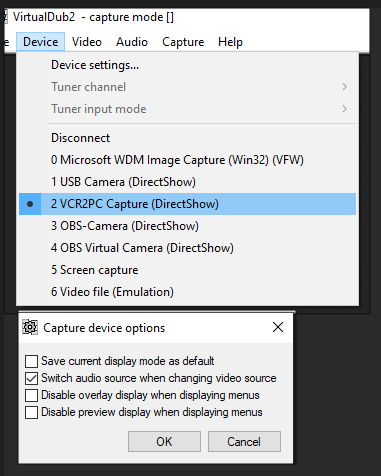

    Here's the device information by the way, thank you for having a look.
    [Attachment 58997 - Click to enlarge]

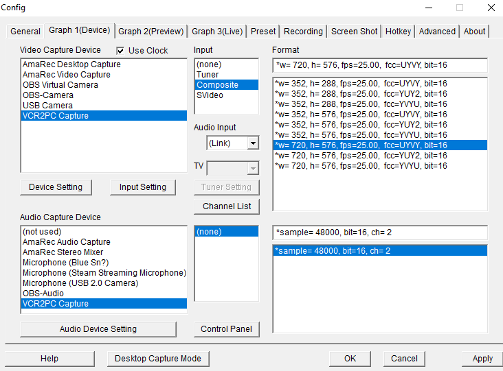

    Thank you AmarecTv+Lagarith is working as long as I don't capture audio. If I have audio selected in the settings I get "Err: acmStreamOpen". This is my settings page
    [Attachment 59238 - Click to enlarge]
  15. Member DB83's Avatar
    Jul 2007
    Did you try either of the first two audio options ? And do you hear audio in the pre-capture preview ?
    You have options that are not present in my selection which makes it difficult to diagnose. But do also check what device is set as default for audio recording under Windows itself.
    May 2021
    England
    Yep tried every option. I selected the vcr2pc in both video and audio as it's the only way to see and hear the vhs playing in the pre-capture preview. In control panel the vcr2pc doesn't show up as an audio recording device though but it does work on obs.
