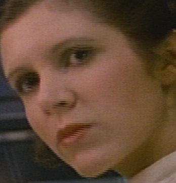

    Somewhat new to AVISynth and I've got my feet wet deinterlacing via QTGMC, now I tried my first Inverse Telecine project. It should be a simple 29.97fps to 23.976fps conversion. Source is NTSC laserdisc captured at 480i. Goal is 720p BD delivery. I'm having what I think is called combing artifacts. I've searched this forum and tried a handful of plugin options TFM(pp=0), ConditionalFilter(last, QTGMC(FPSDivisor=2), last, "IsCombedTIVTC"), SelectEven(). TDecimate(mode=2)
    Depending on which option(s) I use I either get combing artifacts with smooth playback, or no combing artifacts yet get every 20th frame is a duplicate frame with the 22nd frame looking jerky due to the lost 21st frame.
    I figured this project would be as standard as they come being how the original source is film shot at 24fps with 3:2 pulldown. Attached is a still of the combing artifacts, and a clip with the script I used. This script doesn't have the combing artifacts but has the duplicate frames).
    TDecimate(mode=2) gets rid of the combing, yet causes the duplicate frame/jerky issue. Changing to AssumeBFF() gets rid of the duplicate frame, yet causes combing.
    Any help is much appreciated. I've tried every combination I ran across from reading about this issue.

    [Attachment 58975 - Click to enlarge]

  3. Yes, we need a sample of the source. Are you sure it's TFF? Also, in this particular case the subtitle may have confused the decimation. At least as an experiment try cropping it away before TDecimate()

  5. Both times in that clip the problem occurred when the subtitles appeared. I think that's the problem. But you should upload a sample of your source, not processed videos.
    If the subs are the problem you can work around that by splitting the video into top and bottom parts, IVTC'ing them separately, then stacking them back up.

    I uploaded the processed video just to show what issue I'm having. I think you're right about the subtitles being the cause. When I scroll frame by frame, the first frame of the duplicate doesn't have the subtitle then the next frame does, even though it's the same frame as the previous.
