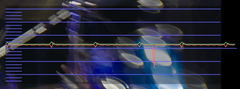

    The frametimes from MPC--BE
    [Attachment 58970 - Click to enlarge]
