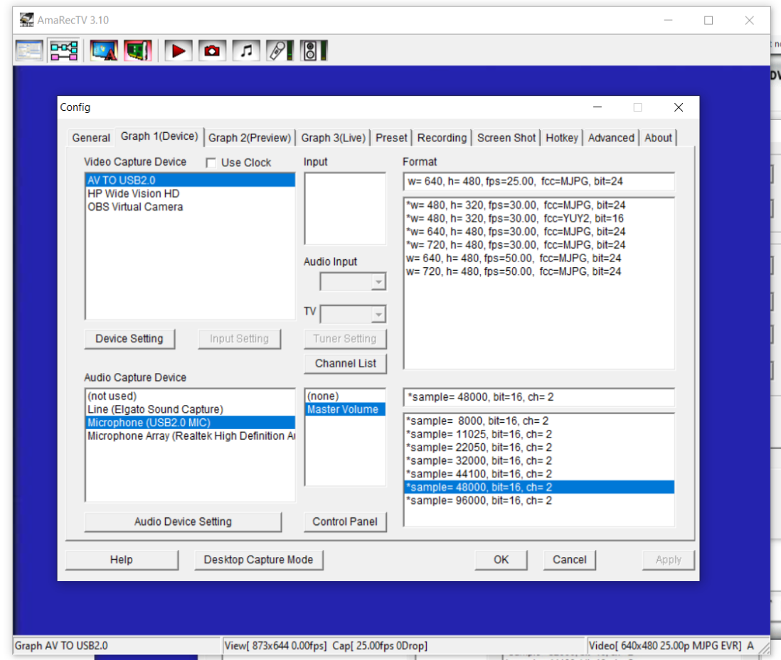

    Except the device doesn't appear to support 704x576, both AmaRecTV and VirtualDub gave me error messages when I tried to use that format. The Honestech software doesn't provide it as an option either.

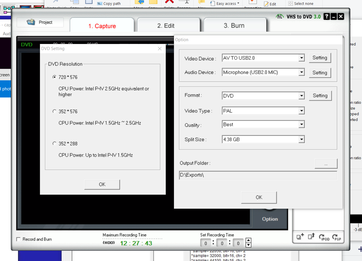

    I've attached a grab of the "devices" tab from AmaRecTV, it shows the formats that my device natively supports, that's what I assume anyway, as the format settings change if I switch to the webcam. Trying to adjust those settings will either give an error message or will just ignore the settings and default to the second in the list, the 480x320, YUA2, 16 bit setting. It will let me adjust framerate for those presets without complaining, but nothing else.
    The other grab is of the Honestech software's available PAL settings, DVD is the highest quality setting I can pick, and it just offers 3 presets, none of which are accepted by AmarRecTV or VirtualDub.
    I'd rather not use the Honestech software though as I don't like the picture quality, VirtualDub and AmaRec seem better in that regard, so should I just record in 640x480? Bearing in mind the videos will be encoded to that on YouTube anyway.

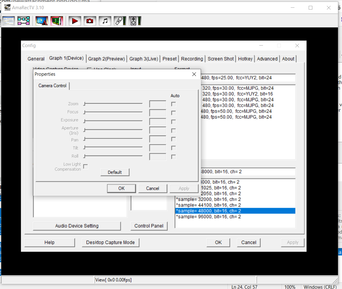

  19. From this image:
    It looks like you have one of those devices that appears as a webcam to Windows. The only resolution it shows with YUY2 (uncompressed video) is 480x320. All the rest are hardware MJPG encoded. It's probably going to deinterlace the video before sending it to the computer too. You're stuck with all it's flaws -- like the wrong resolutions and frame rates, DCT compression artifacts, etc. This is a very bad way to capture video. But try 720x480 at 50 fps. That's about as close as you're going to come the correct values for PAL video.
    What do you get with Device Settings under the Video Capture Device section?

  21. Originally Posted by jagabo View Post
    From this image:
    Thank you! Yes it's a crappy device, I'm well aware of that, it was literally bought to capture a few tapes and will never be used again. If you can recommend a better, inexpensive way of doing it I'm open to it, but that's what came up when I searched for such devices.
    Yes it deinterlaces, that's a good thing for me, because similar devices I've used prior didn't, and the only deinterlacer I liked was in FCP, which took a long time to render and meant I had to re-encode the video, which I don't like doing. So having it done on the fly saves me a lot of time and work. It's deinterlacing seems on par with the FCP one (almost) and better than others I've tried in various apps.
    Bearing in mind these files are for YouTube, should I not just record at 640*480 as that's what viewers will see, I'm never going to watch the source files, they'll just go onto a back up drive. Or will it be better to stick to 720*480?
    Device Settings gives zilch, just a control panel with greyed out, non functional controls, screenshot attached. I'm preferring VirtualDub now anyway. AmaRecTV gives me constant errors and is very poor at explaining what they are.
Name:	amatv device settings.png
