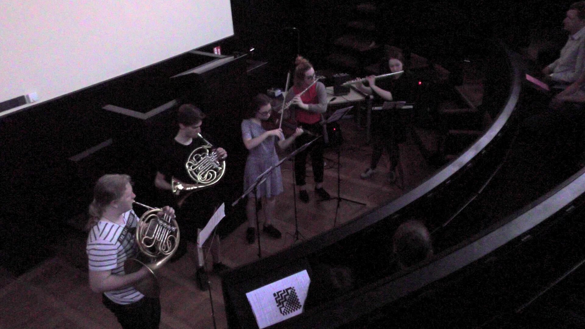

  1. Attaching fragment of dark video that I need to restore. What could be the best method? Can Auto Levels help? https://www.semw-software.com/en/autolevels Thanks.

  7. Manual gain/gamma:
    LWlibavVideoSource("snippetOfDark.avi")
    Trim(6,0)
    ColorYUV(gain_y=400, off_y=-55).ColorYUV(gamma_y=200).ColorYUV(cont_u=500, cont_v=500)
    [Attachment 59096 - Click to enlarge]
  8. Member Cornucopia's Avatar
    The big blob of white in the background (projection screen?) is throwing off the calculations of any auto filters. Either adjust manually as was mentioned, or mask out the white while auto adjusting.
  9. @jagabo: nice,good catch!
  10. Good job, but since that is a fragment of long video, dynamic thing like hdragc is needed.
  11. Originally Posted by Cornucopia View Post
    Any script to mask out the white screen while auto adjusting?
  12. It will only work for that one shot;
    mask = Crop(0,0,-1120,-680).AddBorders(0,0,1120,680).mt_binarize(70).mt_expand().mt_expand().mt_expand().Blur(1.4)
    Overlay(last, ColorYUV(gain_y=-240, off_y=20, cont_u=-240, cont_v=-240), mask=mask)
