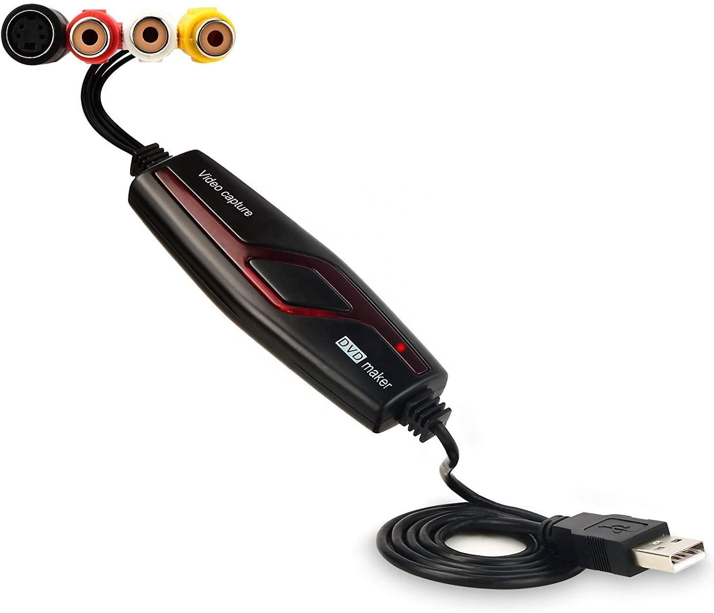

I got this video capture card (called "Video Capture DVD Maker").
[Attachment 58883 - Click to enlarge]
I thought I could used it on Linux (DeepIn) by just connecting... but I was wrong.
Can someone know if there is a way to configure there?
Thank you for any advice.
P.d. Sorry. My english its not so good...
p.d. 2.This is the link of the video capture (for any detail): https://www.alibaba.com/product-detail/Hot-sale-USB-Video-grabber-DVD_472705113.html

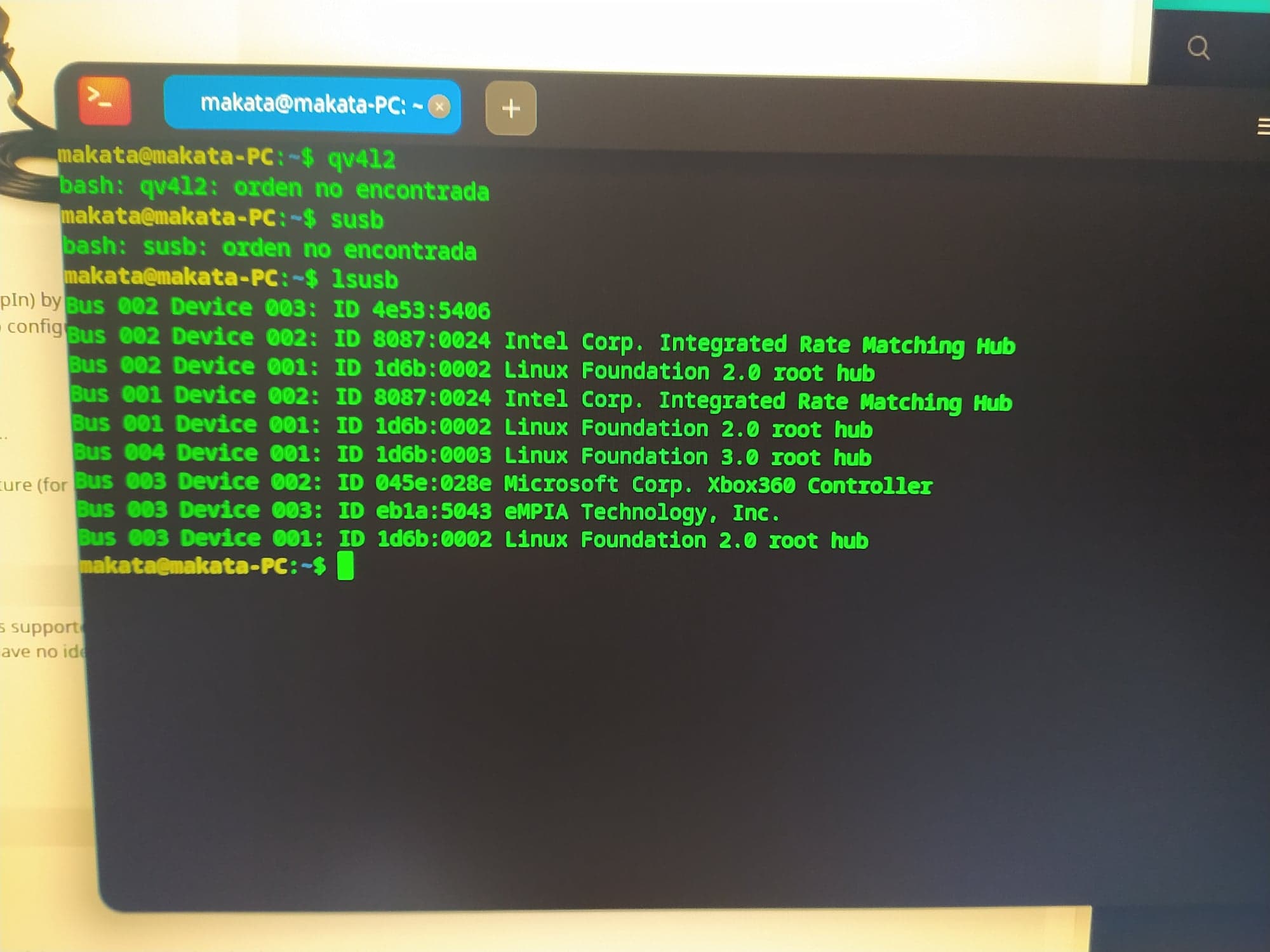

[Attachment 59185 - Click to enlarge]
It show up as "eMPIA TEchnology" -

Hm, it may be using one of the empia all-in-one chips which I don't know whether linux drivers exist for.
The dmesg command (which displays the kernel log) will show if there is any driver loaded after connecting. -
